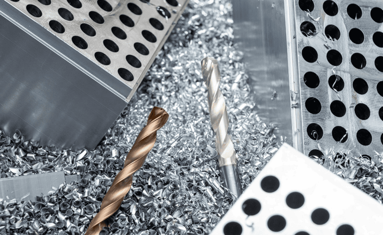

3.    Select a Material Specific Drill
Choosing a material specific drill is one of the easiest ways to avoid hole misalignment. A material specific drill design has geometries that will mitigate the specific challenges that each unique material presents. Further, material specific drills fea­ture tool coatings that are proven to succeed in the specific material a machinist is working in.
