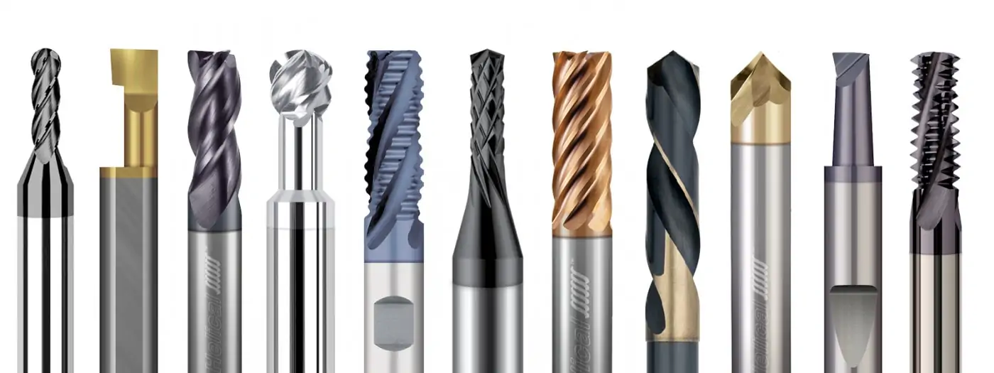

Cutting tools are commonly found with an ultra-thin molecular compound coating applied to its cutting surfaces. These coatings are engineered to combat against forces that wear down your cutting tools and lead to catastrophic tool failure. Not only are coatings created for cutting specific materials, but they also limit heat and friction and enhance the performance of your tool. When selecting a coated tool, the machinist must consider how the material and desired cutting operations may break down the cutting edges of the tool, to determine which coating will best serve their needs. Before those decisions can be made, one must understand how coatings increase a tool’s cutting abilities. The following is an in-depth look into the benefits provided by tool coatings and how they work to improve tool life and performance.
What Is a Coating?
Tool coatings consist of organic and inorganic compounds which are applied and adhered onto the substrate using Physical Vapor Deposition (PVD) or Chemical Vapor Deposition (CVD). Compounds are deposited onto the tools in layers until a desired thickness is achieved.
Coated cutting tools provide three main functions:
  1. Provide a thermal barrier between the tool and workpiece
  2. Improve tool lubricity
  3. Increase tool wear resistance
With the proper utilization of these three features, cutting tools can be pushed much harder, run with faster cycle times, and last longer.
