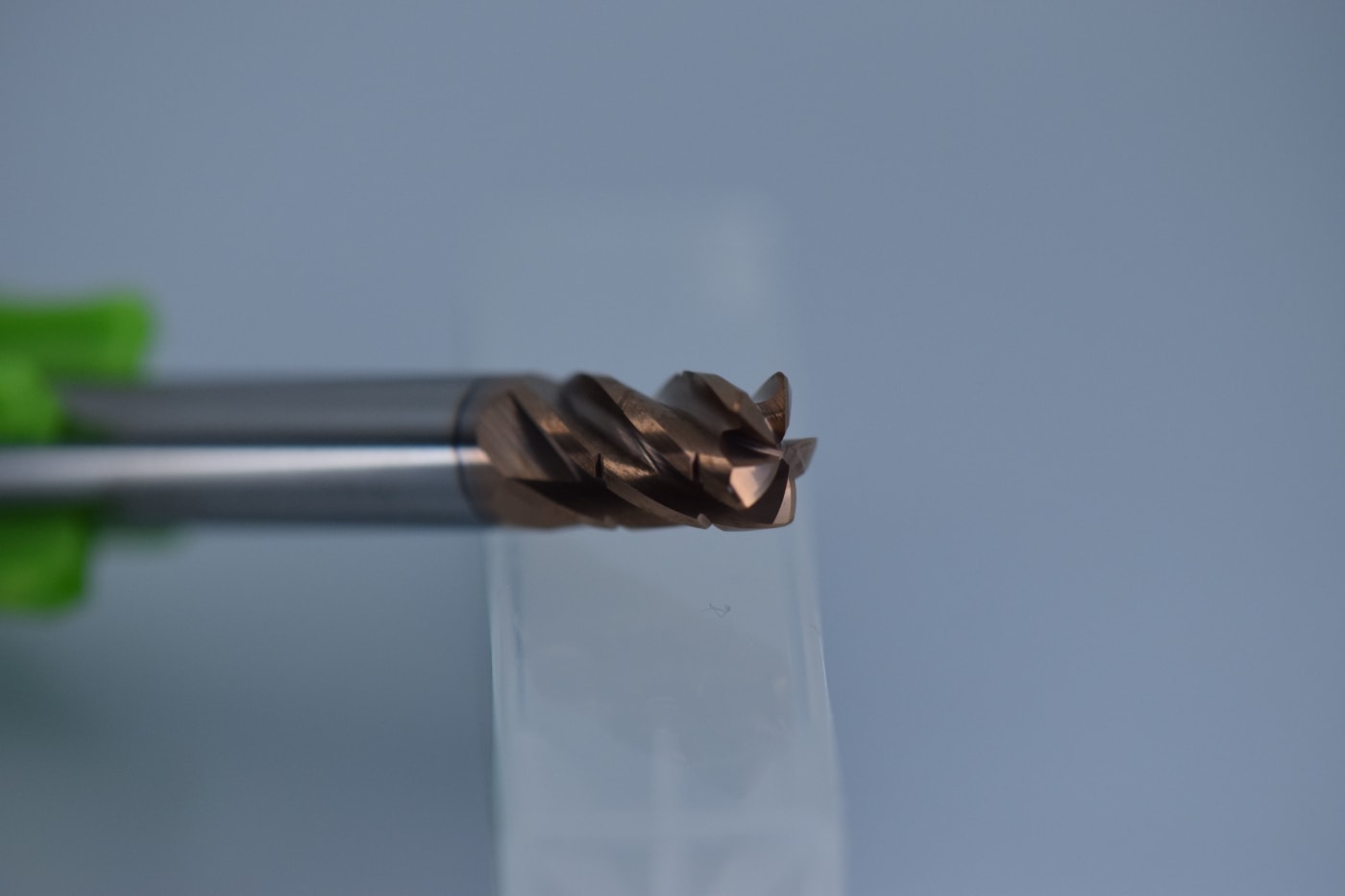

Helical Solutions Combination Feed & HEM end mill
How This Tool Addresses Machine Limitations
A common issue present in a fair number of shops is a limited number of tool stations available. The Combination Feed & HEM products afford the ability to do multiple roughing and finishing operations with one tool, using only one tool position. This eliminates the need to try to blend tools or control multiple offsets in your machining operation.
A second machine limitation that may affect your tool choice is you machine horsepower. The high feed end geometry and the chipbreaker OD geometry are both designed to reduce the amount of power required. This opens up new opportunities within light duty and low horsepower machines, offering more flexibility to your shop.

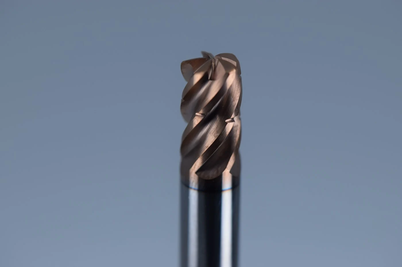

Helical’s Combination Feed & HEM End mills are designed to tackle a broad range of demanding operations in a wide variety of steel types. As these products were engineered to solve machine limitation issues, the end geometry excels across a variety of operations. These include High-Feed milling operations, machining bores, closed or open pockets, internal or external contours, etc. The peripheral geometry was engineered with flexibility in mind. This allows the use of an HEM (High Efficiency Machining) toolpath to achieve high metal removal rates while maintaining great chip control as well as most traditional roughing and finishing strategies.
Helical Solutions Combination Feed & HEM end mill laying over a product container
