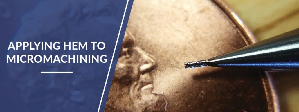

small harvey tool end mill for micromachining on a penny showing size
Tool Fragility & Breakage with Miniature Tooling
Breakage is one of the main challenges associated with utilizing high efficiency micromachining with miniature tools due to the fragility of the tool. Spindle runout and vibration, tool deflection, material inconsistencies, and uneven loading are just some of the problems which can lead to a broken tool. To prevent this, more attention must be paid to the machine setup and material to ensure the tools have the highest chance of success.
As a general rule, HEM should not be considered when using tools with cutting diameters less than .031”. While possible, HEM may still be prohibitively challenging or risky at diameters below .062”, and your application and machine must be considered carefully.
