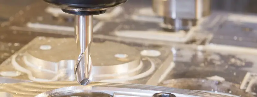

Ball nose end mills are ideal for machining 3-dimensional contour shapes typically found in the mold and die industry, the manufacturing of turbine blades, and fulfilling general part radius requirements. To properly employ a ball nose end mill (with no tilt angle) and gain the optimal tool life and part finish, follow the 2-step process below (see Figure 1).

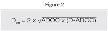

Step One: Calculate Your Effective Cutting Diameter
A ball nose end mill’s Effective Cutting Diameter (Deff) differs from its actual cutting diameter when utilizing an Axial Depth of Cut (ADOC) that is less than the full radius of the ball. Calculating the effective cutting diameter can be done using the chart below that represents some common tool diameters and ADOC combinations or by using the traditional calculation (see Figure 2).
ball nose effective cutting diameter chart
ball nose cutting diameter calculation

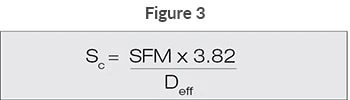

Step Two: Calculate Your Compensated Speed
Given the new effective cutting diameter a “Compensated Speed” will need to be calculated. If you are using less than the cutter diameter, then its likely your RPM’s will need to be adjusted upward (see Figure 3).
ball nose compensated speed calculation

Deff = Effective Cutting Diameter
R = Tool Radius (Dia./2)
RDOC = Radial Depth of Cut

Sc = Compensated Speed
The chart below that represents some common effective cutting diameters and ADOCs at a 15º tilt angle. Otherwise, the traditional calculation below may be used (see Figure 5).
Given the new effective cutting diameter a compensated speed will need to be calculated. If you are using less than the cutter diameter, then its likely your RPM’s will need to be adjusted upward (see Figure 6).

    If anyone is looking to add this to excel…
    =B44*SIN(RADIANS(B45+DEGREES(ACOS(1-((2*B46)/B44)))))
    Where:
    B44 is the Diameter of Cutter
    B45 is Angle in Degrees
    B46 is Depth of Cut

    They don’t talk of feed. is there feed/tooth adjustment?
    • Greg Schranze
      Greg Schranze says:
      August 23, 2024 at 11:52 am
      Hi Marc,
      The adjustment is calculated with the “SC – Compensated Speed” part of the article. This post covers finding your Effective Cutter Diameter which you can linearly interpolate against the speeds and feeds chart to get your RPM. Speeds and Feeds are thus calculated after the fact. Please refer to the Speeds and Feeds 101 article here.
