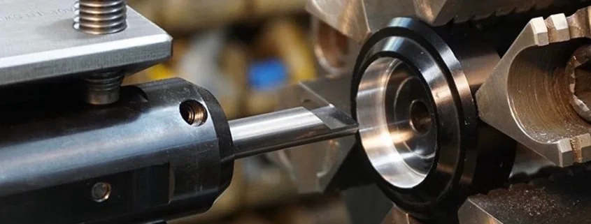

Boring Bar Application Mistake 3: Lacking Workpiece Support
A main cause of chatter in boring applications is lack of support on the workpiece. If a workpiece is not properly supported when entering a boring application, the tool will begin to chatter. Not only is it essential to confirm the proper workholding device is being used, but it’s also important to ensure that your setup is as rigid as possible. Learn more about workholding styles and considerations to make sure you’re supporting your workpiece properly in your next boring application.
Similarly, tool holding also plays a vital role in the performance of a boring bar application. It is important to select a tool holder that accommodates the tooling being used and is as rigid as possible. Many machinists opt for tools that promote machining efficiency by boosting the speed at which tool changes occur. For example cutting tool manufacturer Micro 100 offers Micro-Quik Holders, which offer unmatched rigidity, axial and radial repeatability, tip-to-tip consistency, and part-to-part accuracy in tool changes totaling fewer than 30 seconds.
Micro-Quik tool holder with a tool inserted and pointing towards workpiece
Image Source: @abom79
