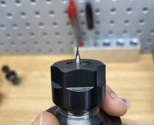

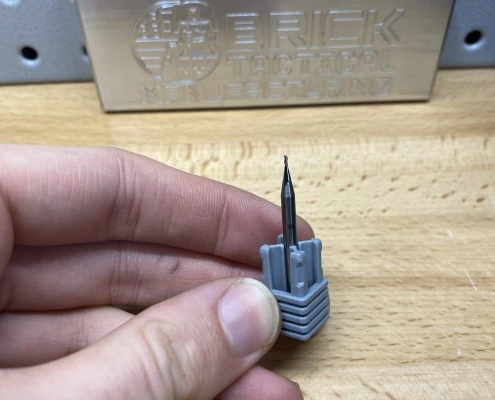

Can you explain the process of creating a custom Lego brick or accessory?
Creating a new custom LEGO weapon/accessory is no easy task. Start off with the idea. Once I have an idea of an item I want to scale down and make into a LEGO mini-figure scale then I get a file designed of that part to scale. Sometimes I do this myself, other times I have one of my designers take care of that. Once I get the file, I normally do a high-resolution SLA 3D print of the part to make sure everything looks and feels right in the mini-figures hand. I might send pictures back and forth with my designer and make changes. This process can take a few weeks to many months depending on the part. Then I take the part file, and I start designing the injection mold. Once designed I program the mold myself and machine it out on my CNC mill. Machining the molds can take many hours, sometimes up to 48 hours straight of machining time to cut the cavities. Then it goes into the molding machine, and we start testing. Sometimes you can get to this step and find a problem and have to repeat this entire process. I do it more than I’m willing to admit, simply because I really care about the little things, some of the things NOBODY would EVER notice, but I notice, so it needs to be fixed. Period. If all is well then it goes into production, and we start cranking them out. The last step is to take photos to list them on the website and promote it!

High-quality tools are very crucial to making high-quality injection molds. They go hand and hand. Being a solo entrepreneur I also don’t have the time to check lower grade tooling to make sure it’s up to my standards of run out, sharpness, etc. Buying from high-quality tooling companies takes those variables out of the equation. Also having speeds and feeds ready to go when buying new tools saves time and broken tools. It at least gives me a baseline of where to start playing with my numbers.
