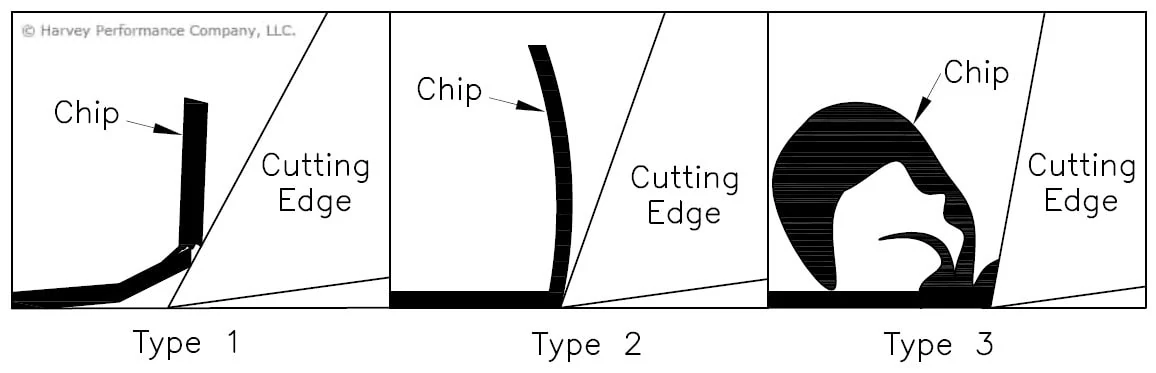

The Proper Formation of Wood Chips With CNC Woodworking
When cutting wood parallel to the grain, there are three basic types of chips that are formed. When cutting perpendicular to the grain, the chip types generally fall into these same 3 categories, but with much more variability due to the wide range in wood properties with respect to the grain direction.
Type 1 Chips
Type 1 chips are formed when wood splits ahead of the cutting edge through cleavage until failure in bending occurs as a cantilever beam. A large force perpendicular to the shear plane is produced, causing the wood ahead of the cutting edge to split, forming this tiny cantilever beam. When the upward force finally exceeds the strength of this tiny beam, it breaks off.  These types of chips cause comparatively little wear compared to types 2 and 3, as the material is splitting before coming in contact with the pointed edge. End mills with either extremely high rake or very low rake angles often produce type 1 chips. This is especially true when machining against grain slopes that are greater than 25°. Woods with moisture content less than 8%form discontinuous chips and are at a higher risk of tear-out.
Type 2 Chips
Type 2 chips are the most desirable of the three types in terms of surface finish. They are a result of material failure along a diagonal shear plane, extending from the cutting edge to the workpiece surface. Type 2 chips form when there is a proper balance between the properties of the wood, cutting parameters, and cutter geometry. Woods with a moisture content between 8% and 20%have a much higher chance of forming continuous type 2 chips while leaving a good surface finish.
Type 3 Chips
The last type of chip forms when the rake angle of a cutter is much too low. In this scenario, the cutting force is almost parallel to the direction of travel. This causes a soft material, such as wood, to be crushed rather than sheared away, leaving a poor surface finish. Generally, the surface left behind looks like tiny bundles of wood elements, a surface defect commonly known as “fuzzy grain.” This type of chip occurs more frequently in softwoods as the crushing situation is compounded in low-density woods.
types of wood chips in woodworking
Figure 2: Different types of wooden chips

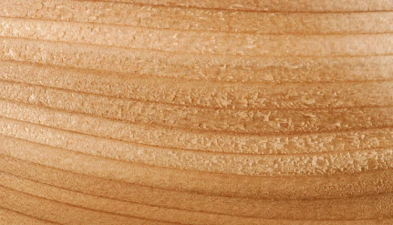

Fuzzy Grain Finish
Fuzzy grain looks like small clumps of wood attached to the newly machined face and occurs when the wood fibers are not severed properly. Low rake or dull cutting tools indent fibers until they tear out from their natural pattern inside, causing type 3 chips to form, resulting in a poor finish. This can be exacerbated by a low feed or depth of cut as the tool is not properly engaged and is plowing material rather than shearing it properly. Softer woods with smaller and lesser amounts of grains are more susceptible to this type of defect. Juvenile wood is known to be particularly liable for fuzzy grain because of its high moisture content.
fuzzy grain wood finish
Figure 5: Example of a fuzzy grain finish
