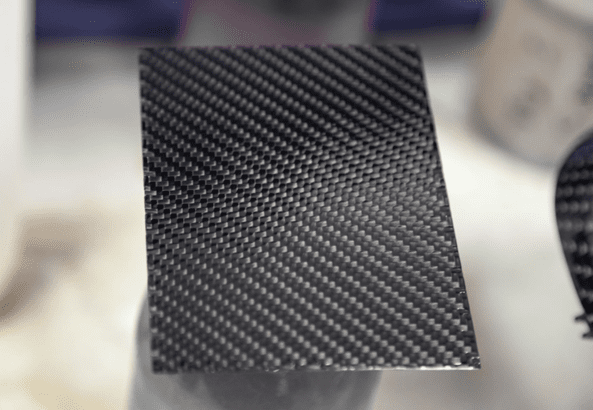

Carbon Fiber Reinforced Polymers (CFRP) is a collection of carbon fibers that, when bound together via resin, creates a material with a wide range of application possibilities. It’s strong, durable, and resistant to corrosion, making it an advantageous material for use in several advanced industries, including the aerospace and automotive industries. Despite its unique abilities, however, machining CFRP is not without its set of challenges, all of which machinists must be cognizant of to achieve desired results. Once CFRP is properly understood and the right cutting tool is selected for the job, the next step is to properly set running parameters for your application.
Square piece of cfrp laminate carbon fiber material

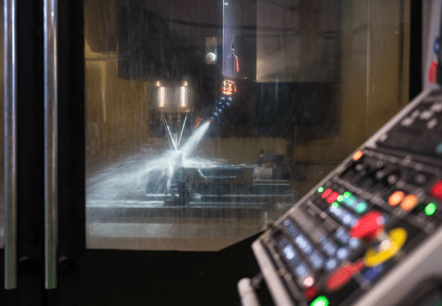

Coolant Applications
The use of coolant when machining CFRP can either benefit or negatively affect the part depending on the application. The preferred coolant of choice for machining carbon fiber is typically using water or a water-soluble coolant. This is due to composites having a porous surface that could allow contaminates to enter the part itself. By using water, it prevents any issues after machining where adhesives or paint may need to be applied to the part that otherwise would not have adhered properly with contaminates present.
cnc machine looking through glass window focusing on a tool in the cut with external coolant spraying the workpiece
