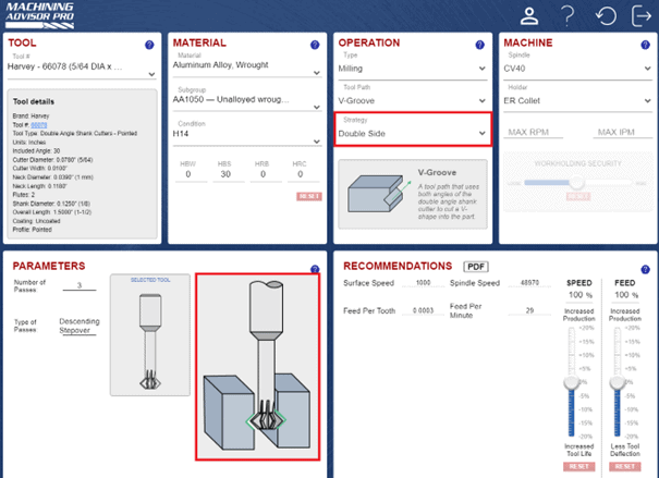

New Strategy Option for Operations
Before the MAP 2.0 update, there were only two drop down menus for operation: type and toolpath. With the new update, there is an additional third operation drop down menu titled “strategy.” This option allows for users to further refine their machining operation, but only for certain tools that require it. For example, when using a Double Angle Shank Cutter on MAP, users can choose from a list of toolpaths including deburring, chamfer, or v-groove.
Once selected, users will choose a strategy for the toolpath – single side or double side engagement. The use of this feature gives the user more flexibility in their operations and saves time by automating their operation calculations. This feature is available for a variety of different toolpaths within the application.
