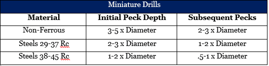

Miniature Drills
miniature drill pecking cycles

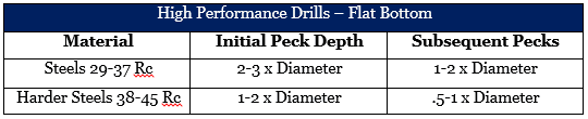

High Performance Drills – Flat Bottom
high performance drill pecking cycles

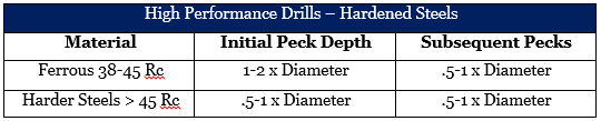

High Performance Drills – Hardened Steels
hardened steels chart

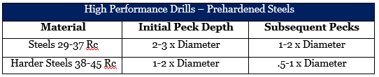

High Performance Drills – Prehardened Steels
prehardened steels chart
Key Pecking Cycle Takeaways
From the above tables, it’s easy to identify how recommended peck drilling cycles change based on the properties of the material being machined. Unsurprisingly, the harder the material is, the shorter the recommended pecking depths are. As always, miniature drills with a diameter of less than .010″ are extremely fragile and require special precautions to avoid immediate failure. For help with your specific job, contact the Harvey Tool Technical Team at 800-645-5609 or [email protected]
