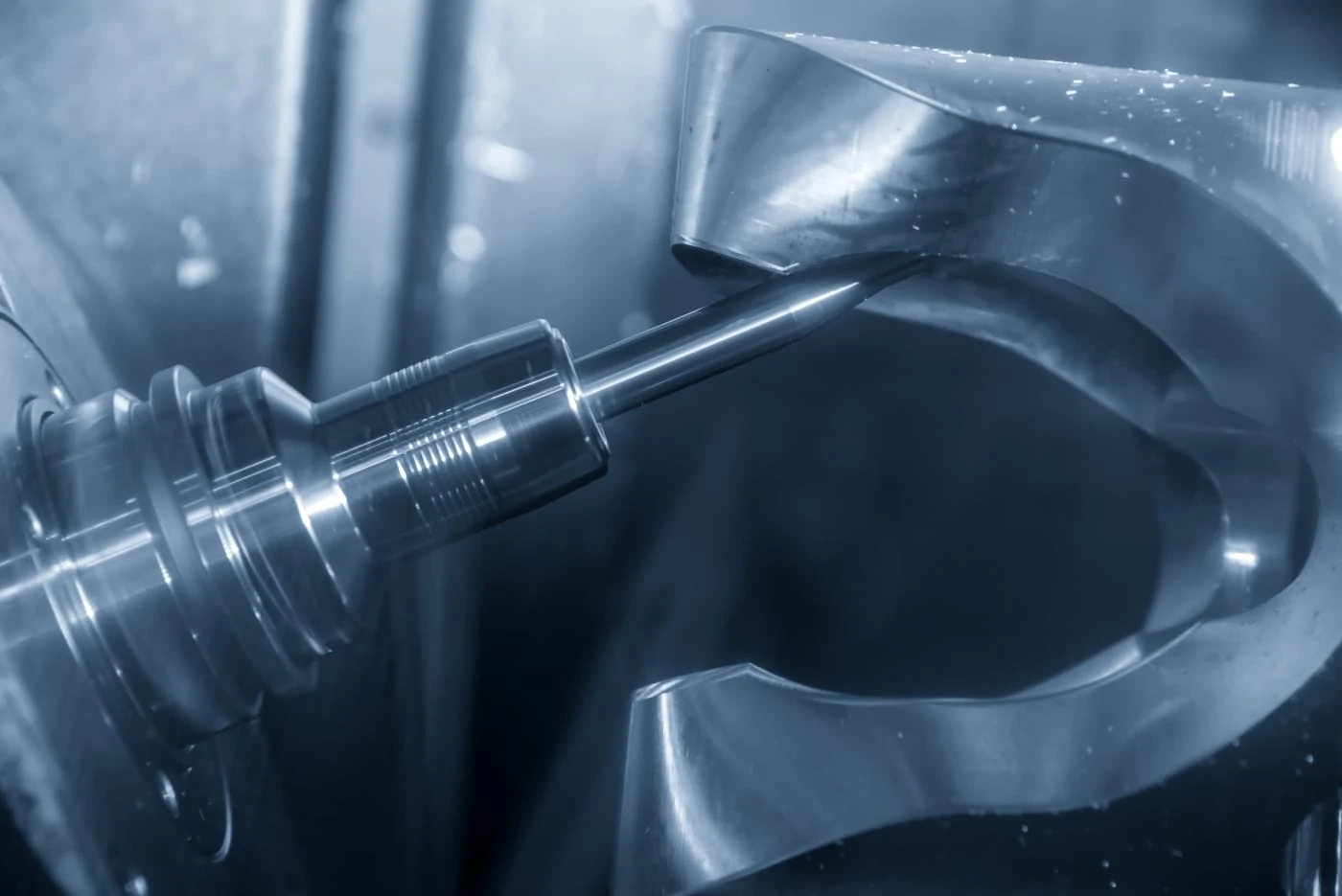

Using CNC Machining to Create Precise 3D Printed Parts
Looking at the chart above, you will notice that one of the key differences between additive manufacturing and subtractive manufacturing is the surface finish and tolerances that can be achieved with each method. This is where a hybrid approach to additive manufacturing can be extremely beneficial.
As parts come off the printer, they can be quickly moved into a CNC machine with a program designed for part completion. The CNC machine will be able to get 3D printed parts down to the tight tolerances required by many industries and reach the desired surface finish. Advanced finishing tools and long reach, tapered tools from brands like Harvey Tool can easily machine the tight geometries of 3D printed parts, while extremely sharp diamond-coated tooling and material-specific tools designed for plastics and composites can work to create a beautiful, in-tolerance finished part regardless of the material.
long reach end mill
Long reach tools can easily machine hard to reach, intricate part details on 3D printed parts.
By designing a workflow like this in your shop, you can spend less time worrying about the precision of printed parts by adding in subtractive operations to keep material costs low, create less waste, and keep parts in tight tolerances for precision machining excellence.

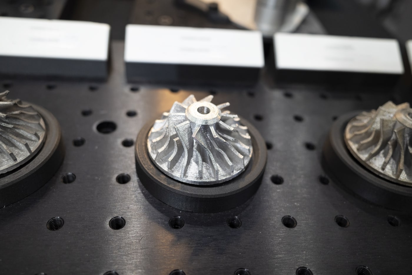

For example, you could machine the bulk of a part with typical subtractive machines, which would likely take a very long time using additive methods. Then you can go back to that part with a 3D printer to add intricate features to the part that may take complex programming and hours of planning on a subtractive machine. An impeller is a great example, where the bulk of that part can be machined, but the tricky fins and blades could be printed onto the part, and then finished back on the CNC machine.
