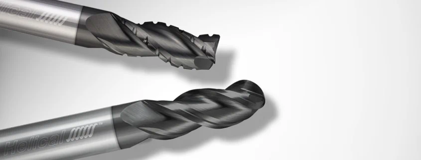

Helical’s Dplus is a premium coating, specially engineered to extend tool life when machining materials ranging from aerospace aluminums to graphite or abrasive composites. It has a Tetrahedral Amorphous Carbon (taC) bond structure, which delivers remarkable enhancements in tool life compared to traditional DLC coatings.
Helical’s Dplus coating is applied by a Physical Vapor Deposition (PVD) process. This method of coating takes place in a near-vacuum and distributes micron-thick layers evenly onto a properly prepared tool. Since this coating is applied via a PVD process, it is inherently different than true diamond created through Chemical Vapor Deposition (CVD) processes. While this means it can be outlasted by CVD diamond, Dplus is a thinner coating allowing it to have a sharper cutting edge.

Dplus is an excellent choice when working in abrasive non-ferrous materials like graphite and high-silicon aluminums. It is an extremely hard coating (50 Gpa), which enables it to remain strong against abrasive materials. It also has a very low coefficient of friction, allowing for optimal lubricity. This reduces the risk of built-up edge and ensures chips can be easily evacuated out of the flute valleys.
