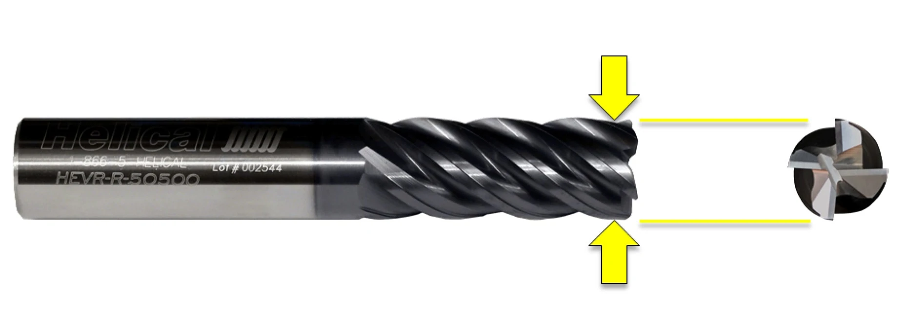

Cutter Diameter
The cutter diameter is often the first thing machinists look for when choosing a tool for their job. This dimension refers to the diameter of the theoretical circle formed by the cutting edges as the tool rotates.

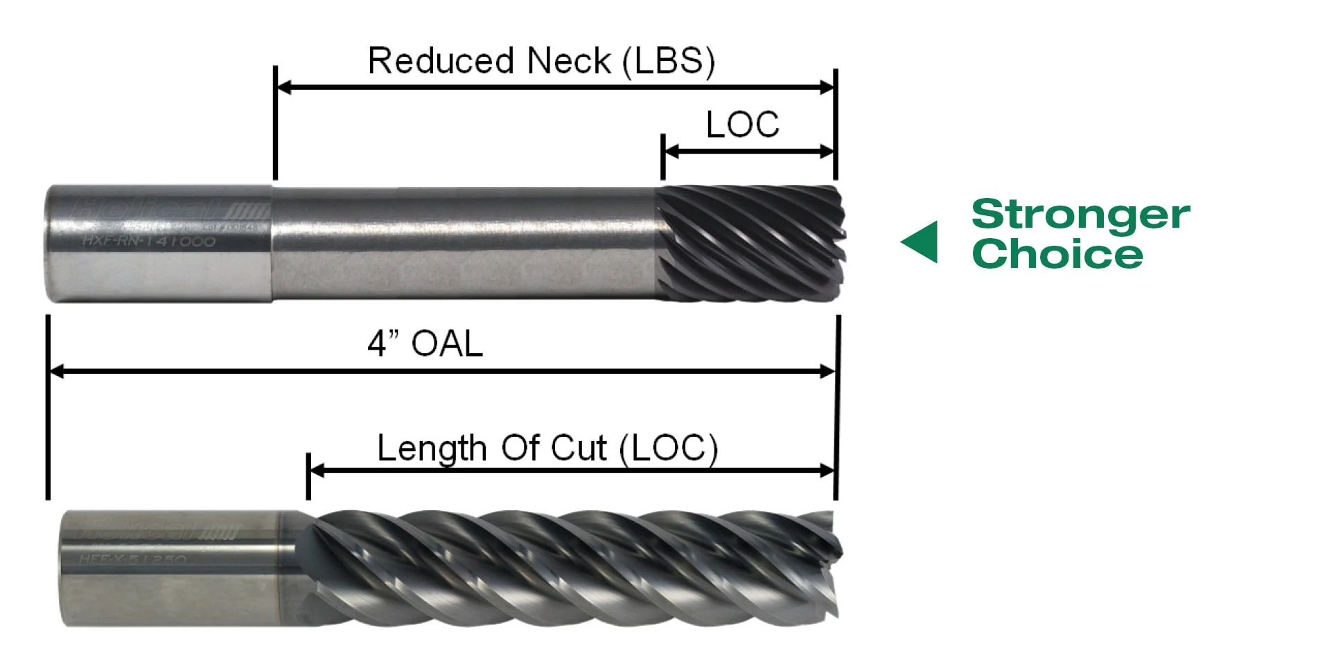

Overall Length (OAL) & Length of Cut (LOC)
Overall length is easy to decipher, as it is simply the measurement between the two axial ends of the tool. This differs from the length of cut (LOC), which is a measurement of the functional cutting depth in the axial direction and does not include other parts of the tool, such as its shank.

Overall Reach/Length Below Shank (LBS)
The overall reach of an end mill, or length below shank (LBS), is a dimension that describes the necked length of reached tools. It is measured from the start of the necked portion to the bottom of the cutting end of the tool.  The neck relief allows space for chip evacuation and prevents the shank from rubbing in deep-pocket milling applications. This is illustrated in the photo below of a tool with a reduced neck.

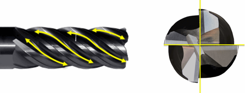

End Mill Helix Angle
The helix angle of a tool is measured by the angle formed between the centerline of the tool and a straight line tangent along the cutting edge. A higher helix angle used for finishing (45°, for example) wraps around the tool faster and makes for a more aggressive cut. A lower helix angle (35°) wraps slower and would have a stronger cutting edge, optimized for the toughest roughing applications.
showcase of end mill helix angle compared to core
A moderate helix angle of 40° would result in a tool able to perform basic roughing, slotting, and finishing operations with good results. Implementing a helix angle that varies slightly between flutes is a technique used to combat chatter in some high-performance tooling. A variable helix creates irregular timing between cuts, and can dampen reverberations that could otherwise lead to chatter.

    I just don’t get this. How is the endmill with the higher helix angle going to cut “more aggressively”? An endmill with a lower helix angle should lift the chip further with each revolution. Wouldn’t this make for a more aggressive cut, particullarly when plunging or machining a slot? Please explain.
      February 20, 2019 at 4:24 pm
      Hi Jimbo,
      When it comes to a lower helix removing chips faster, we tend to disagree. As a helix becomes shallower, the vertical forces on each chip become less and are therefore unable to lift chips as quickly. As a helix becomes less and less, there is less lifting force on the chips and they are moved vertically at a far slower rate. A higher helix will actually lift chips more than a lower helix.
      We thought you raised a great point about the high helix angle and how it wraps around the tool faster, making for an aggressive cut, and we agree that this could be misleading. We’ll rework this portion to provide more clarity. What we meant was that there are merits to using a high helix tool in an HEM fashion, since a higher helix causes more points of contact between the tool and the workpiece. This helps to provide stability to cut faster, and even provide more stability in thin wall applications. When we say “aggressive,” we’re referring more the nature of a high helix and less its use in HEM, specifically. A higher helix is more aggressive than a lower helix due to higher shear forces on the workpiece, and higher lifting forces, which can get too high in certain workholding situations.
      Finally, to provide more clarity on your point that chips must be lifted up through the flutes to be evacuated, this is correct for drills as there is nowhere else for the chips to go. For end mills, especially in low radial engagement situations such as with HEM, chips are ejected radially and are not really getting the chance to move up through the flutes. That small amount of vertical motion will actually be more with a higher helix.
