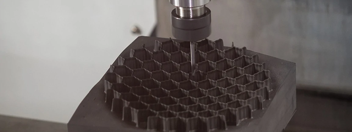

Since graphite is such a soft and brittle material, special consideration needs to be made when machining to avoid chipping it. To get a good cut, it is recommended that you take light chip loads and use lower feed rates in graphite. If you were to take a heavy cut at a fast feed rate, you would start chipping the graphite and could cause it to fracture completely. To give a comparison point, chip loads for graphite are similar to those for Aluminum materials, but with less than half the feed rate.
To give you an idea of speeds and feeds for graphite, here is an example using a 1/4″ Harvey Tool CVD Diamond Coated, 4 flute Square End Mill. If that tool was running at a standard RPM of 12,000 at 780 SFM, the recommended chip load would be .00292 for a feed rate of 140 IPM.
electrode machining
In terms of machine setup, the one major tip to remember is to always avoid using coolant. Graphite is a fairly porous material, and so it can absorb coolant and act as a “coolant sponge,” which will cause problems with finished parts. Inside the machine and on the tooling, the coolant can actually react with the graphite dust and create an abrasive slurry, which will cause problems while machining. A vacuum system is recommended for clearing material while machining graphite. Otherwise, coated tools should be able to run dry.
Another thing to note when machining graphite is that because graphite does not produce chips, but rather a cloud of very abrasive dust, it can be harmful to operators and machines without proper care. Operators should be wearing a protective mask to avoid inhaling the graphite dust. Proper ventilation and maintaining air quality in the shop is also key for the protection of machinists when working in graphite.
Since the graphite dust is also extremely conductive, it can easily damage non-protective circuits inside your CNC machine, which can cause major electrical issues. While coolant is not recommended, a vacuum system can help to remove the dust, keeping it from accumulating too much inside the machine and preventing serious problems.
