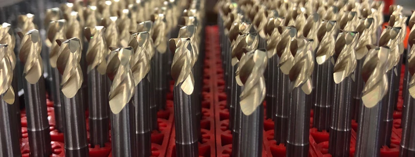

We have shown our end users bits and pieces of our manufacturing process on our website and via social media, but for the first time we decided to open our own doors to the public and show you every step behind how we manufacture and fulfill the Helical Solutions product. We partnered with John Saunders from NYC CNC to create a “Factory Tour” video, covering topics like our CNC grinding machines and setups, tool manufacturing, and our warehouse organization and fulfillment procedures.
In the video below, we first toured our Gorham, Maine manufacturing plan with Plant Manager Adam Martin. Then, we ran a few tests with the Helical tools on our Haas machine, before heading back to our warehouse in Massachusetts to talk about fulfillment and new products with Fulfillment Manager Megan Townsley.
