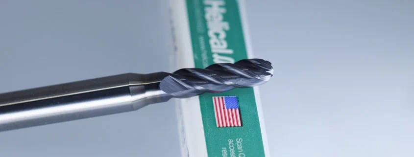

Ball Nose Taper Mills
Ball Nose Tapered End Mills are great for profiling because the full radius at the bottom eliminates sharp edges, which leads to a smoother process.

4 Flute Ball (HTPR-4)
Helical’s 4 Flute Ball Tapered End Mills (HTPR-4) are fully stocked in 6 different angles per side (0.5°, 1°, 1.5°, 2°, 3°, 5°), and in 3 different cutter diameters (1/8”, 3/16”, ¼”). These tools feature a ball nose profile, allowing them to excel in a variety of different applications from 3D contouring and profiling to slotting. A Ball Nose End Mill has a full form radius, allowing machinists to utilize the entire radius when contouring and finishing a 3D surface.
