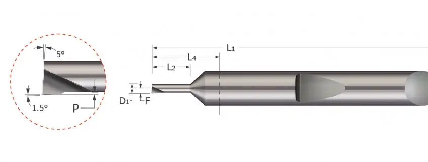

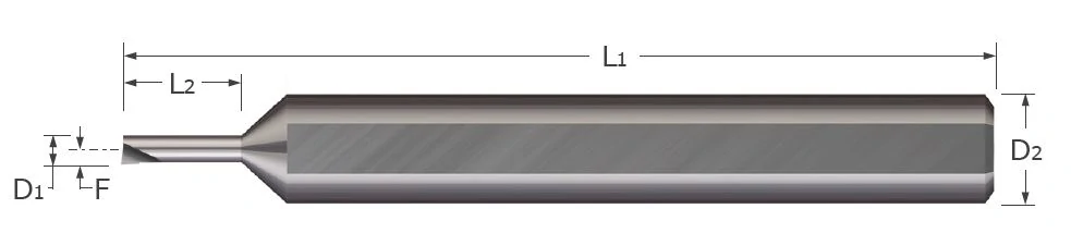

Solid carbide boring bars, such as those offered by Micro 100,  have a few standard dimensions that give the tool basic functionality in removing material from an internal bore. These include:
Minimum Bore Diameter (D1): The minimum diameter of a hole for the cutting end of the tool to completely fit inside without making contact at opposing sides
Maximum Bore Depth (L2): Maximum depth that the tool can reach inside a hole without contact from the shank portion
Shank Diameter (D2): Diameter of the portion of the tool in contact with the tool holder
Overall Length (L1): Total length of the tool
Centerline Offset (F): The distance between a tool’s tip and the shank’s centerline axis

In order to minimize tool deflection and therefore risk of tool failure, it is important to choose a tool with a max bore depth that is only slightly larger than the length it is intended to cut. It is also beneficial to maximize the boring bar and shank diameter as this will increase the rigidity of the tool. This must be balanced with leaving enough room for chips to evacuate. This balance ultimately comes down to the material being bored. A harder material with a lower feed rate and depths of cut may not need as much space for chips to evacuate, but may require a larger and more rigid tool. Conversely, a softer material with more aggressive running parameters will need more room for chip evacuation, but may not require as rigid of a tool.

Defining the Geometric Features of a Boring Bar:
Nose Radius: the roundness of a tool’s cutting point
Side Clearance (Radial Clearance): The angle measuring the tilt of the nose relative to the axis parallel to the centerline of the tool
End Clearance (Axial Clearance): The angle measuring the tilt of the end face relative to the axis running perpendicular to the centerline of the tool
Side Rake Angle: The angle measuring the sideways tilt of the side face of the tool
Back Rake Angle: The angle measuring the degree to which the back face is tilted in relation to the centerline of the workpiece
Side Relief Angle: The angle measuring how far the bottom face is tilted away from the workpiece
End Relief Angle: The angle measuring the tilt of the end face relative to the line running perpendicular to the center axis of the tool
boring bar geometric features
