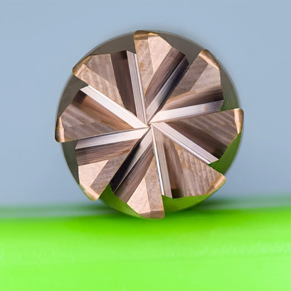

8 flute HVNI End Mill for Machining Nickel Alloys
Shown above is Helical Solutions’ End Mill for Nickel Alloys. This tool, engineered to excel in Inconel 718 and other nickel-based superalloys, is fully stocked in 6 and 8 flute styles.

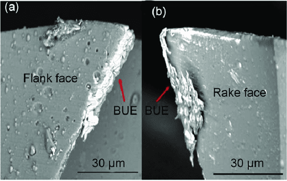

As nickel alloys are being machined and heat is generated, chips tend to become stringy and weld themselves to a tool’s cutting edge. This phenomenon, built up edge or BUE, rounds the cutting edge of the tool, resulting in poor cuts and increased friction, thus further contributing to work hardening. An example of BUE is seen in the image below.
Zoomed in display of built-up edge on End Mill Flutes
On the above tool, chips from the workpiece (Inconel 718) have welded onto the cutting edge, severely decreasing the tool’s effectiveness. Image Source: International Journal of Extreme Manufacturing
Built-up edge also speeds up tool wear, as the rotational forces involved in the cut increase. Now that the cutting edge is rounded from welded chips, a blunt tool is being forced into the workpiece.
With a blunt edge, the cutting motion changes from a shearing action to plowing. In other words, instead of cutting through the metal, the tool is pushing the material, resulting in poor cuts and increased friction.

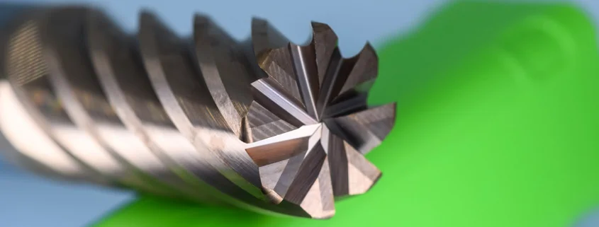

Next is selecting flute count. Tools used for nickel alloys need to be rigid to withstand the cutting forces present when machining high hardness alloys. Therefore, higher flute counts are necessary. If using traditional roughing toolpaths, your end mill should have at least 6 flutes. With 6 flutes, there is sufficient flute valley depth to allow for chip evacuation, while having a larger core diameter keeps the tool strong and rigid.
For finishing operations and instances of implementing high efficiency milling, higher flute counts should be considered. A tool used this way should have 8 flutes to provide excellent surface finish.

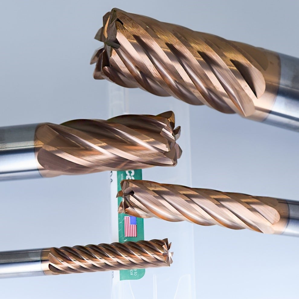

Four Helical Solutions End Mills for Nickel Alloys positioned over a Helical product container
The tools shown above are Helical Solutions’ End Mills for Nickel Alloys. These tools are coated in Tplus for high hardness, resulting in improved tool life and increased strength,
With its Tplus coating and variable pitch to minimize chatter, these solid carbide end mills are engineered to perform in all grades of nickel alloys. Coupled with their geometry to maximize cutting performance, Helical’s End Mills for Nickel Alloys utilize faster speeds and feeds, which are readily available on the Helical Solutions’ website and Machining Advisor Pro.
