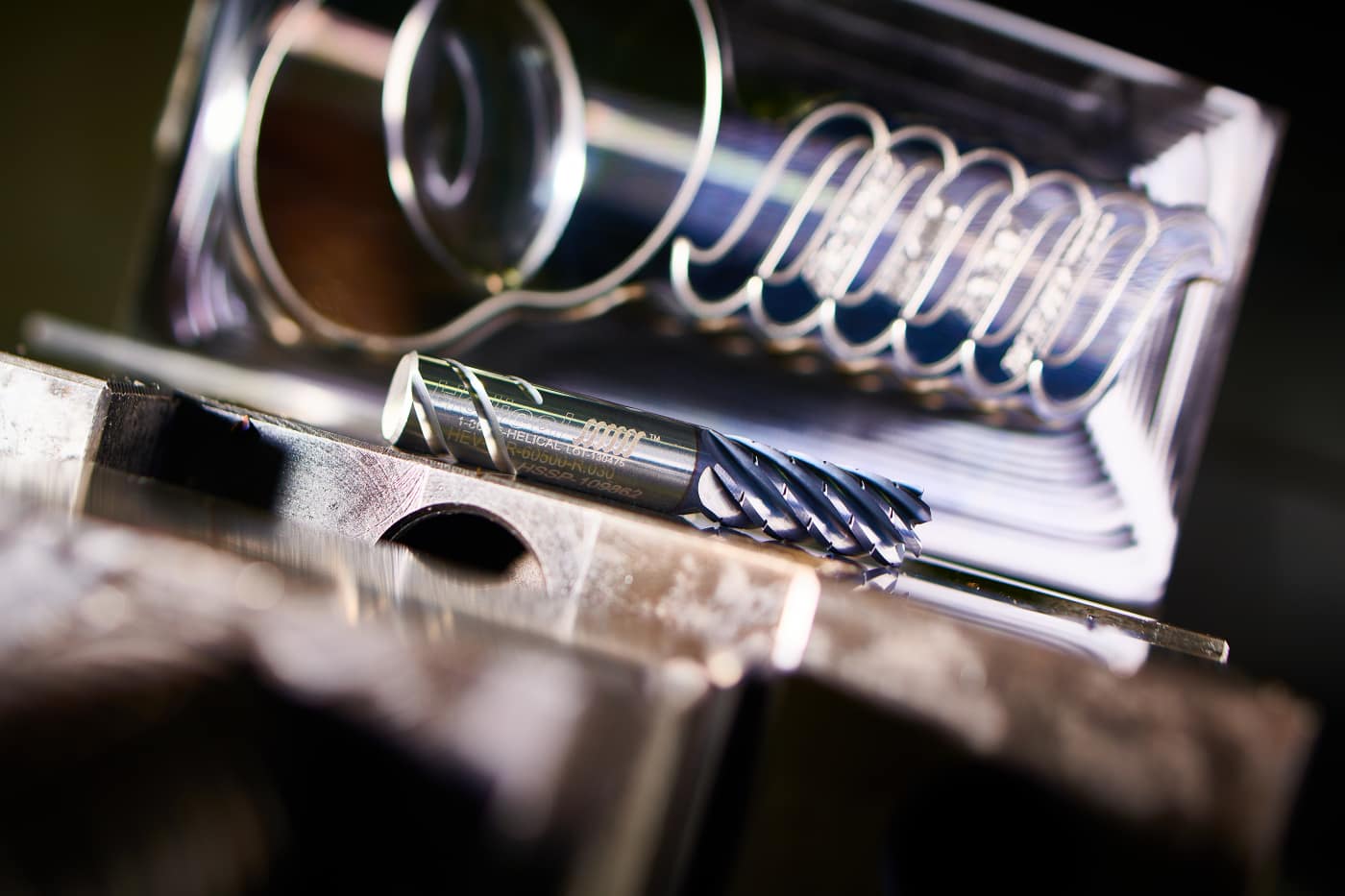

Utilizing HEM with Helical Solutions’ HEV-C-6 chipbreaker with Mastercam software, Makino machinists were able to use a Makino PS105 VMC to achieve a new industry standard in MRR for 4140 steel alloy.
Setting a New Material Removal Rate Benchmark with Helical
Engineered for HEM, Helical’s HEV-C-6 was designed for optimal chip evacuation and reduced tool harmonics at high RPMs. Makino machinists utilized these features wit Mastercam’s highly effective tool paths, resulting in a very impressive MRR.
Watch the video below from Makino to see these impressive feats.
Inside the machine, the HEV-C-6 was spun at 10,695 RPM with Mastercam’s impressively efficient toolpaths to achieve an incredible 40in3 MRR.

All tools can only be pushed to the limits of the machine and material. So the goal was to watch the machine’s spindle load to give 100% or greater efficiency of the machine. We also wanted to use a combination of radial step over, axial stepdown, and Feed per Minute to maximize the MRR, as well.
