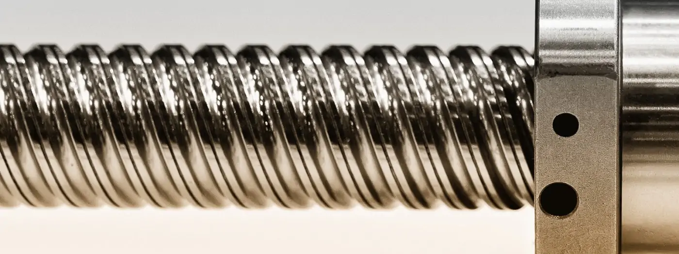

A multi-start thread consists of two or more intertwined threads running parallel to one another. Intertwining threads allow the lead distance of a thread to be increased without changing its pitch. A double start thread will have a lead distance double that of a single start thread of the same pitch, a triple start thread will have a lead distance three times longer than a single start thread of the same pitch, and so on.
Shop Harvey Tool’s Comprehensive Offering of Fully Stocked Threadmills
By maintaining a constant pitch, the depth of the thread, measured from crest to root, will also remain constant. This allows multi-start threads to maintain a shallow thread depth relative to their longer lead distance. Another design advantage of a multi-start thread is that more contact surface is engaged in a single thread rotation. A common example is a cap on a plastic water bottle. The cap will screw on in one quick turn but because a multi start thread was used there are multiple threads fully engaged to securely hold the cap in place.
