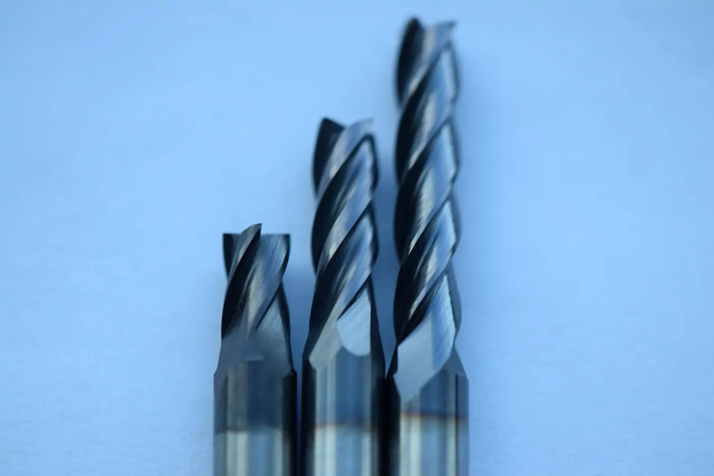

Three Harvey tool AlTiN coated end mills
Above is an example of a Harvey Tool AlTiN Coated tool, which is applied using a PVD process.

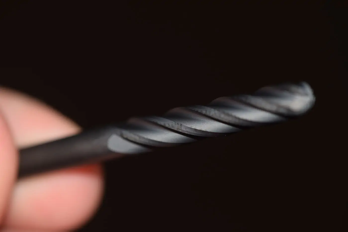

Harvey tool CVD ball end mill held in person's hand
Above is an example of a Harvey Tool CVD Ball End Mill.
