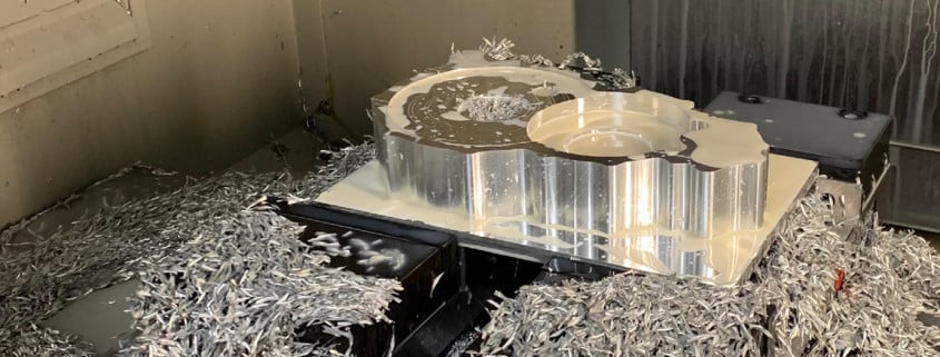

While building your new vehicle for the 2019 season, what are some of the common materials you have been machining?
For the 2019 build, we have been working with a lot of 7075 and 6061 Aluminum. We manufacture our own gears in house, so we also do a lot of steel and some hard milling, which is a key area where the Helical end mills have helped us get better performance.

Just generally speaking we are a collegiate team, so we don’t have the luxury of buying nice tools. We typically end up getting a lot of free stuff from suppliers, but do not get to choose the tools like we do with Harvey and Helical. With the donated tools we have to be very careful with our speeds and feeds, because what works for one part might not work for another. It can be really difficult to dial anything in and run it confidently.
Using your tools has been hugely beneficial. We know the performance we are going to get from the tools is consistent, and we can always rely on getting immaculate finishes. The tools’ performance also cut down our cycle times on a lot of parts, which is instrumental to our ability to crank out more parts. While using the Harvey Tool and Helical product, we can confidently walk away from the machine and come back to a quality finished part every time.
