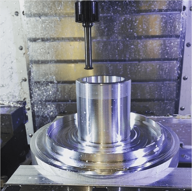

What is your favorite job you have worked on?
I just finished a production run on a job where I completed 12 pieces of two different parts out of hardened 17-4 stainless from start to finish. The cycle time was just over four hours. Each part required three operations after the stock was sawed and heat treated. I designed, modeled, and made two sets of fixtures for each operation in order to load one set while the other was being machined.

thread mill
Coolant-Through Multi Form Thread Mills
Coolant-Through Multi Form Thread Mills are the perfect tool for when a job calls for thread milling in a blind hole. The coolant through ability of the tool produces superior chip evacuation. These tools also improve coolant flow to the workpiece – delivering it directly from the tip of the tool – for decreased friction and high cutting speeds.
thread mill
Long Flute
These tools are great when a job calls for a deep thread, due to their long flute. Long Flutes also have a large cutter diameter and core, which provides the tool with improved tool strength and stability.
thread mill
N.P.T. Multi-Form
While it may seem obvious, N.P.T. Multi-Form Thread Mills are perfect for milling NPT threads. NPT threads are great for when a part requires a full seal, different from traditional threads that hold pieces together without the water-tight seal.
