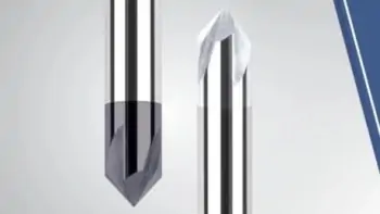

Harvey Tool Chamfer Cutters
Type I: Pointed
