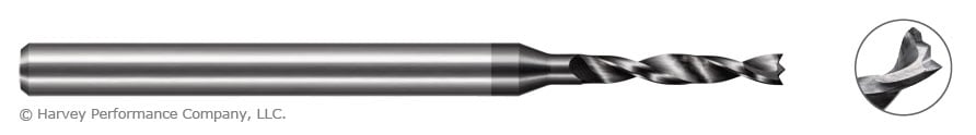

Brad Point Composite Drills
Avoid Uncut Fibers and Tear Out
composite drills
Harvey Tool’s Brad Point Composite Drills are designed specifically for superior performance in fibrous materials. The trident-like brad point ensures that holes in fiber filled and reinforced materials come out clear and free of fraying. The outer points accurately score the outer diameter of drilled holes, eliminating uncut fibers, tear-out, and splintering.
