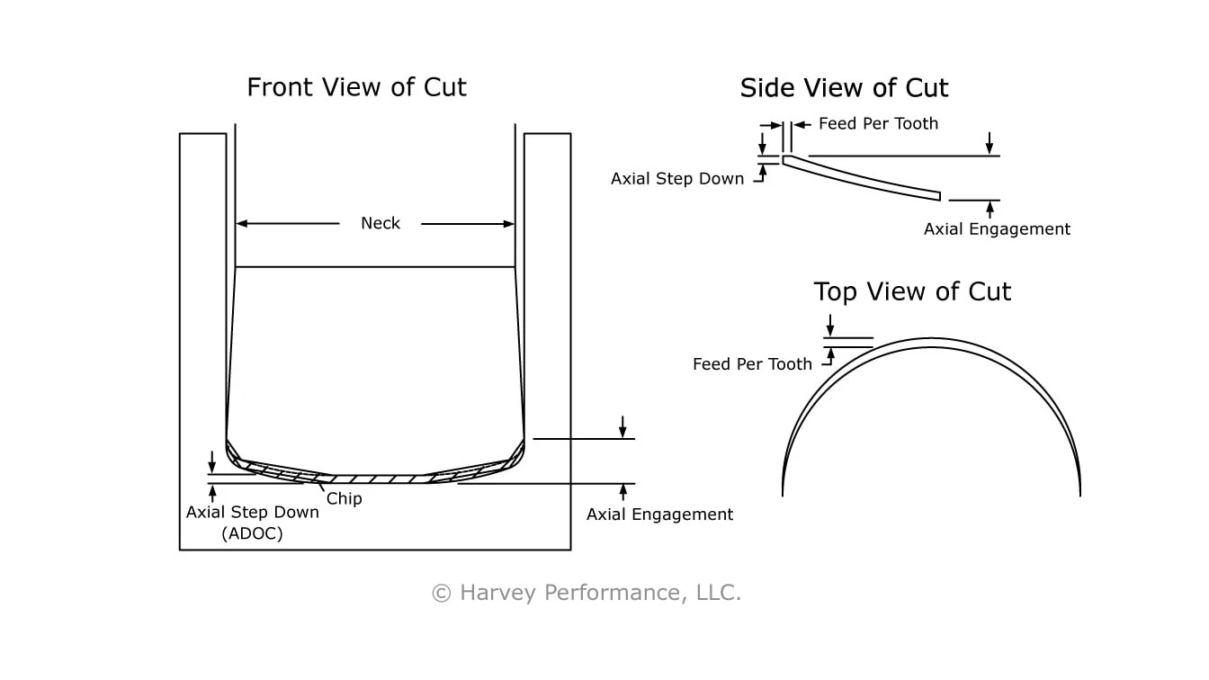

Feed Mills Have Aggressive Feed Rates
Figure 1 also depicts an instantaneous snapshot of the chip being formed when engaged in a proper roughing tool path. Notice how the chip (marked by diagonal lines) thins as it approaches the center axis of the tool. This is due to the curved geometry of the bottom edge. Because of this chip thinning phenomenon, the feed of the tool must be increased so that the tool is actively engaged in cutting and does not rub against the workpiece. Rubbing will increase friction, which in turn raises the level of heat around the cutting zone and causes premature tool wear. Because this tool requires an increased chip load to maintain a viable cutting edge, the tool has been given the name “High Feed Mill.”

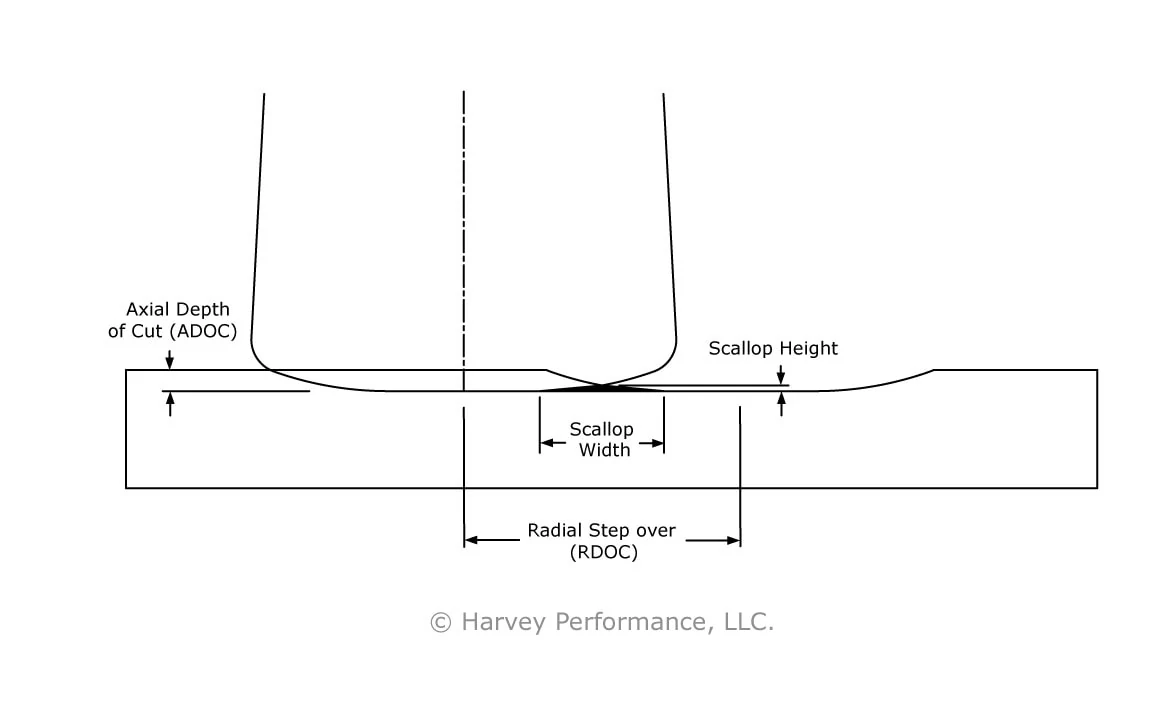

Managing Scallops
A scallop is a cusp of material left behind by cutting tools with curved profiles. Three major factors that determine the height and width of scallops are:
  1. Axial Depth of Cut
  2. Radial Depth of Cut
  3. Curvature of Bottom Edge or Lead Angle
Figure 3 below is a depiction of the scallop profile of a typical roughing cut with a 65% radial step over and 4% axial depth of cut. The shaded region represents the scallop that is left behind after 2 roughing passes and runs parallel to the tool path.
roughing cut scallop profile
Figure 3: Back view of roughing cut with a 65% radial step over

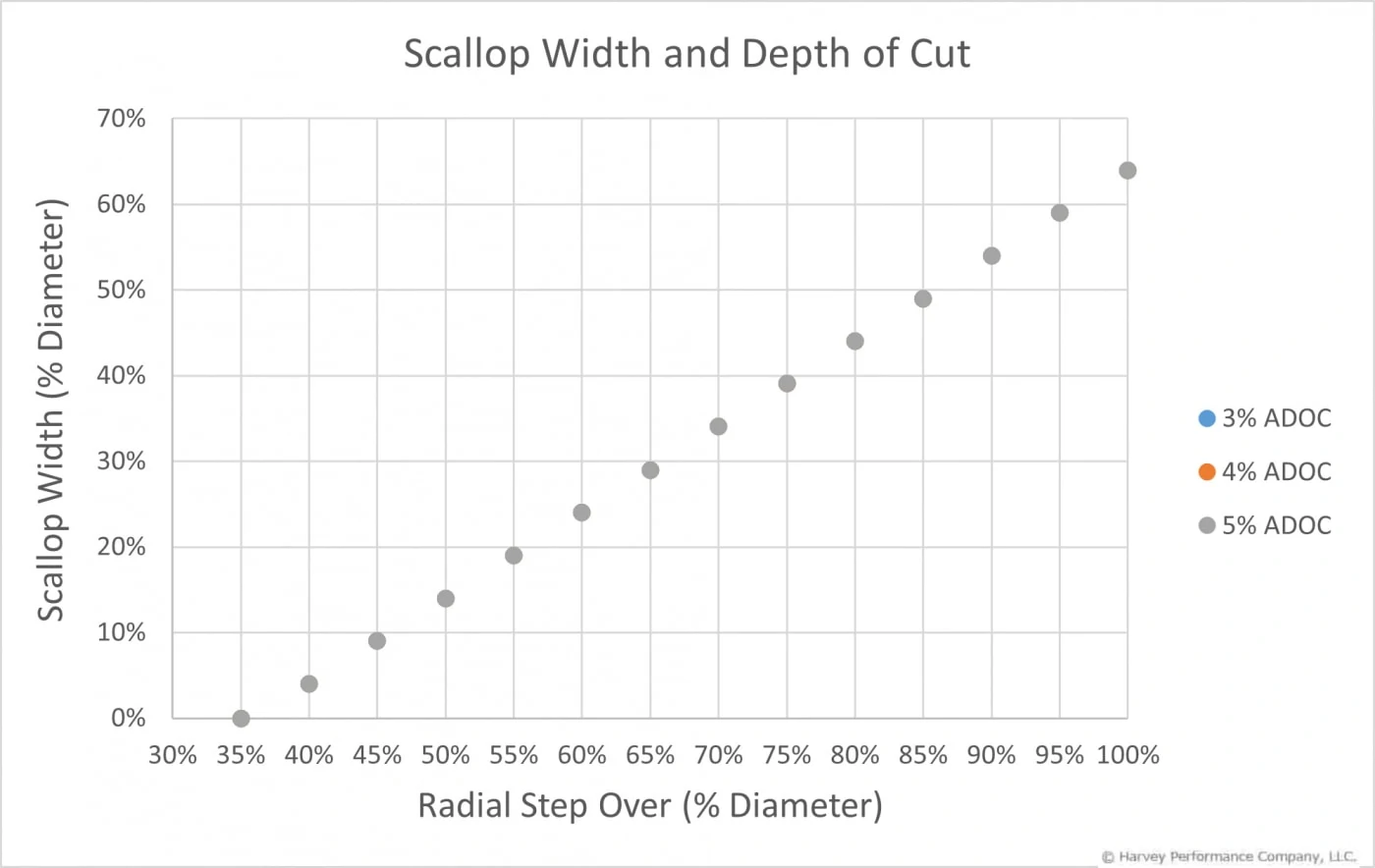

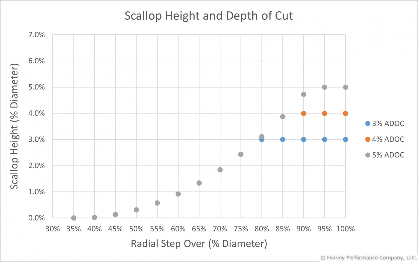

Figures 4 and 5 show the effects of radial and axial depth of cuts on the height and width of scallops. These figures should be viewed in the context of Figure 3. Percentage by diameter is used rather than standard units of measurement to show that this effect can be predicted at any tool size. Figure 4 shows that a scallop begins to form when the tool is programmed to have a radial step over between 35% and 40%. The height increases exponentially until it is maximized at the axial depth of cut. Figure 5 shows that there is a linear relationship between the radial step over and scallop width. No relationship is seen between scallop width and axial depth of cut as long as ADOC and the radius of curvature of the bottom cutting edge remains consistent.
graph of scallop height versus depth of cut
Figure 4: Graph of Scallop Height vs. Depth of Cut
graph of scallop width versus depth of cut
Figure 5: Scallop Width vs. Depth of Cut
From the graphs in Figures 4 and 5 we get the following equations for scallop dimensions.
Notes regarding these equations:
  • These equations are only applicable for Helical Solutions High Feed End Mills
  • These equations are approximations
  • Scallop height equation is inaccurate after the axial depth of cut is reached
  • RDOC is in terms of diameter percentage (.55 x Diameter, .65 x Diameter, etc…)

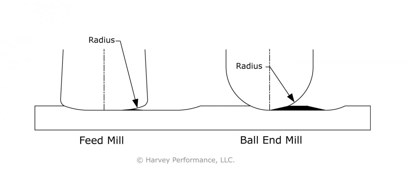

Curvature of the Bottom Edge of High Feed End Mills
The smaller the radius of curvature, the larger the height of the scallop. For example, the large partial radius of the Helical Solutions High Feed End Mill bottom cutting edge will leave a smaller scallop when compared to a ball end mill programmed with the same tool path. Figure 6 shows a side by side comparison of a ball end mill and high feed mill with the same radial and axial depth of cut. The scallop width and height are noticeably greater for the ball end mill because it has a smaller radius of curvature.
feed mill versus ball end mill
Figure 6: Scallop diagram of High Feed Mill and Ball End Mill with the same workpiece engagement

Figure 7: Formation of a chip when a feed mill is engaged in a full slotting operation.
