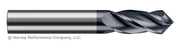

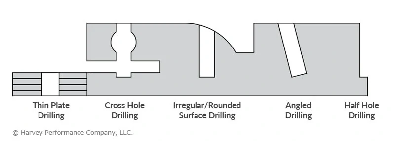

Drill/End Mills
drill mills
One look at Drill/End Mills or “Drill Mills” and it’s obvious that these multi-functional tools are capable of more than a standard end mill. Two of the intended operations are right in the name (drilling and milling). Besides the obvious, though, drill mills are intended for grooving, spotting, and chamfering, bringing the total to five separate operations.
drill mill operations
Considering the amount of tools normally required to perform all of these common operations, keeping a few drill mills in your tool crib ensures you’re always ready to tackle them, not to mention the potential extra spots in your tool magazine.

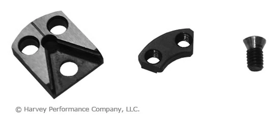

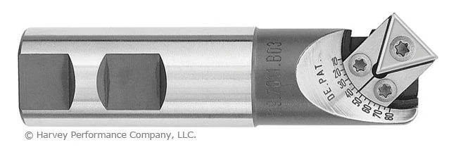

Adjustable Chamfer Cutters
adjustable chamfer cutters
As discussed in a previous post, chamfer mills are capable of more than just chamfering – they are also well-suited for beveling, deburring, spotting, and countersinking. However, these adjustable chamfer cutters aren’t limited to a single angle per side – with a quick adjustment to the carbide insert you can mill any angle from 10° to 80°.
chamfer cutter inserts
When you account for the replaceable insert and the range of angles, this tool has a very high potential for time and tool cost savings.
