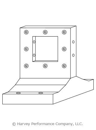

The 4 Fixture Bodies
There are 4 basic types of fixture bodies: faceplates, baseplates, angle plates, and tombstones.
Faceplates: Typically used in lathe operations, where components are secured to the faceplate and then mounted onto the spindle.
Baseplates: Common in milling and drilling operations and are mounted to the worktable.
Angle plates: Two plates perpendicular to each other but some are adjustable or customized to change the angle of the workpiece.
Tombstones: Large vertically oriented rectangular fixtures that orients a workpiece perpendicular to the worktable. Tombstones also have two sides to accommodate multiple parts.
fixture body
