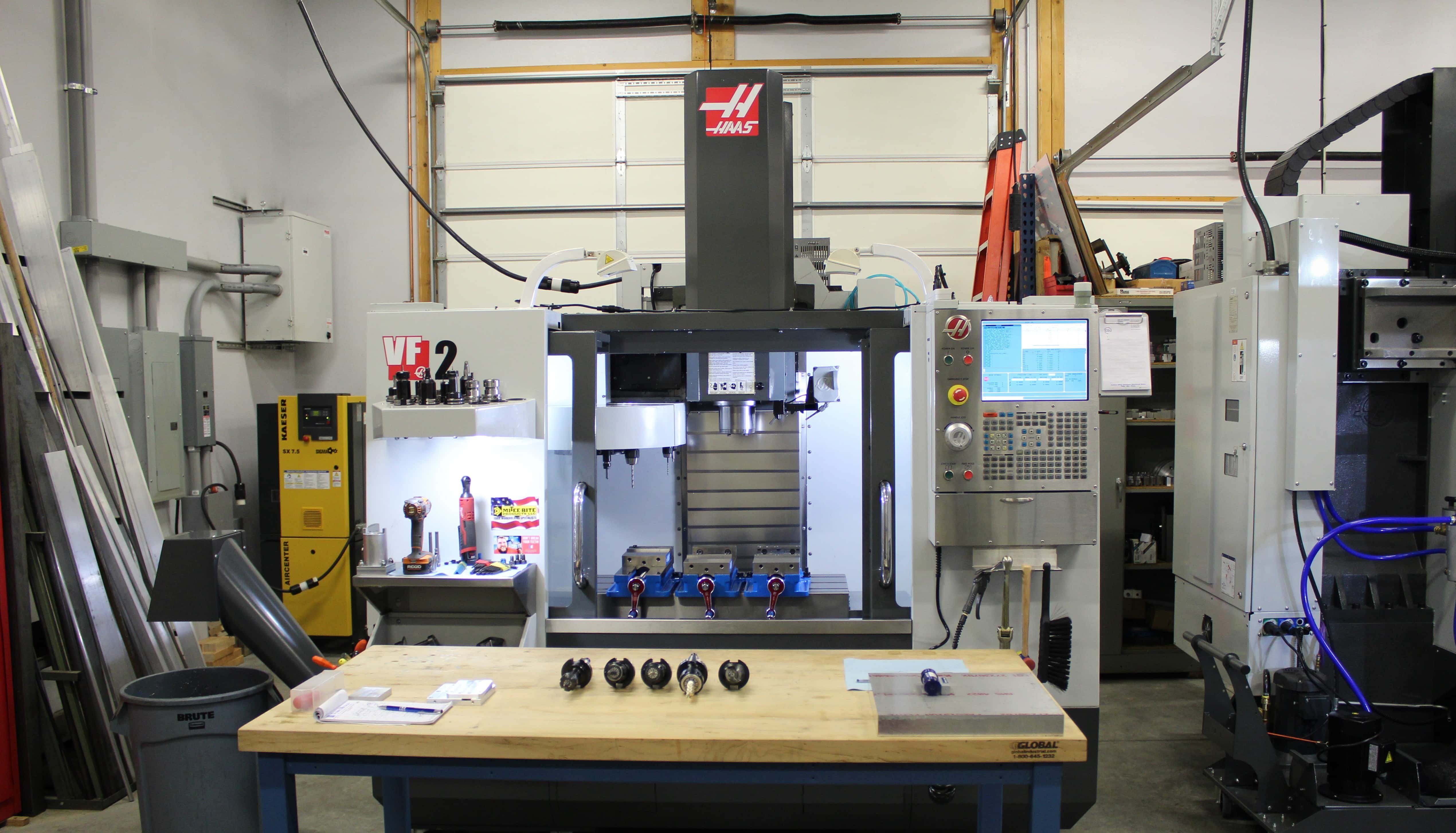

What sort of machines and CAM software do you have in your new shop?
Right now for CNC machines I have a 2018 Haas VM3, a 2018 Hass VM2, a 2012 Haas VF2, and a 2012 Haas TL2. I also have an engine lathe, a Bridgeport knee mill, Kaeser screw compressor, which I absolutely love, and a couple of Jet saws.
For software, I still use GibbsCAM. I have been using GibbsCAM since 1996 and have had countless hours of training and experience using it, so I think I’m a lifer.

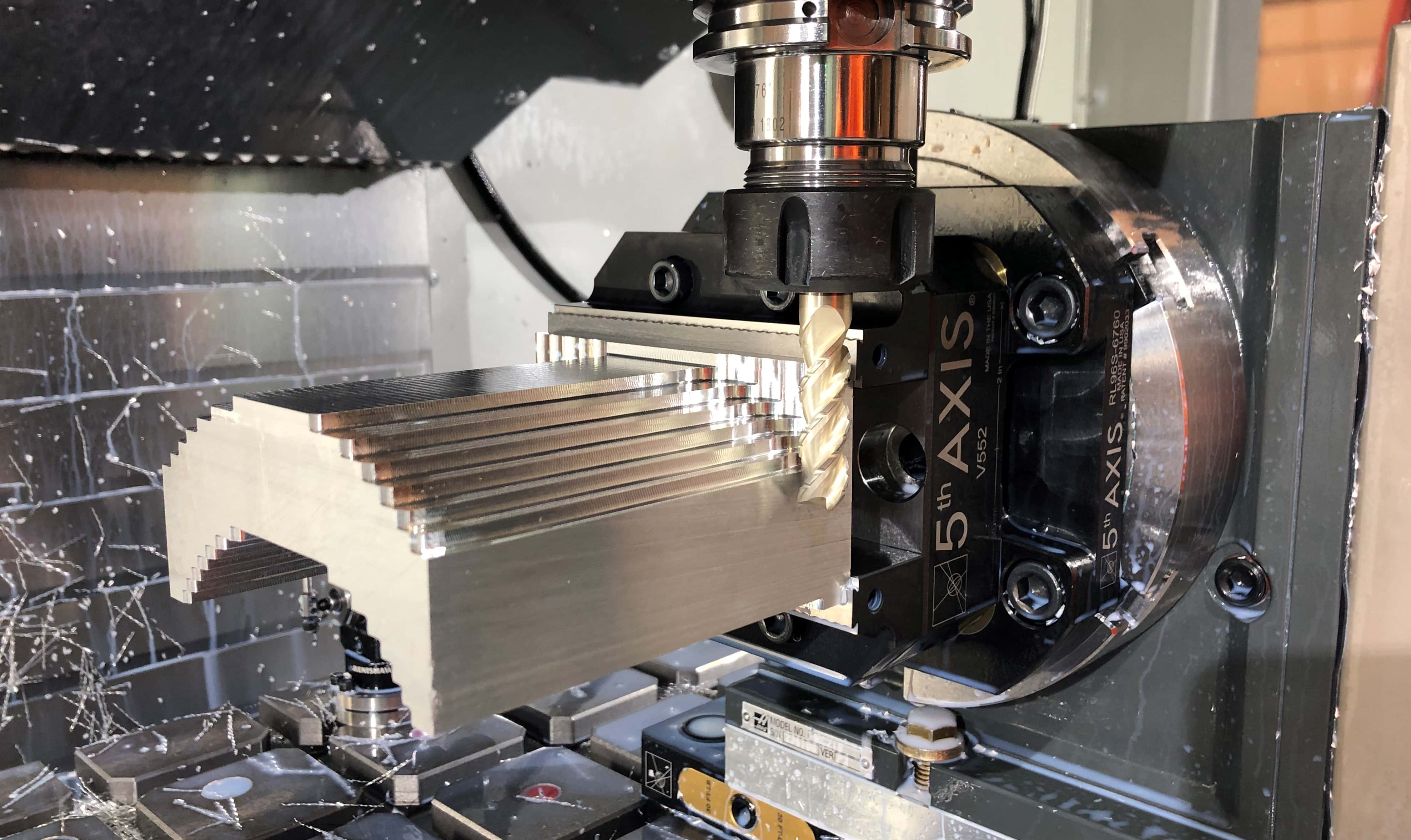

5th axis workholding
Photo Courtesy of: Nueva Precision
I also feel strongly about having solid workholding. I have a couple of the 5th Axis self-centering vises which are great, and a handful of Kurt vises, as well. I am also a big fan of the MMM-USA guys and their vise jaws and handles. For my shop, flexibility is key because I never know what can come through the door. I don’t do a lot of production work and spend much more time on prototype work, so flexibility is key. Having good quality workholding that I don’t need to worry about lets me swap parts in and out with ease.

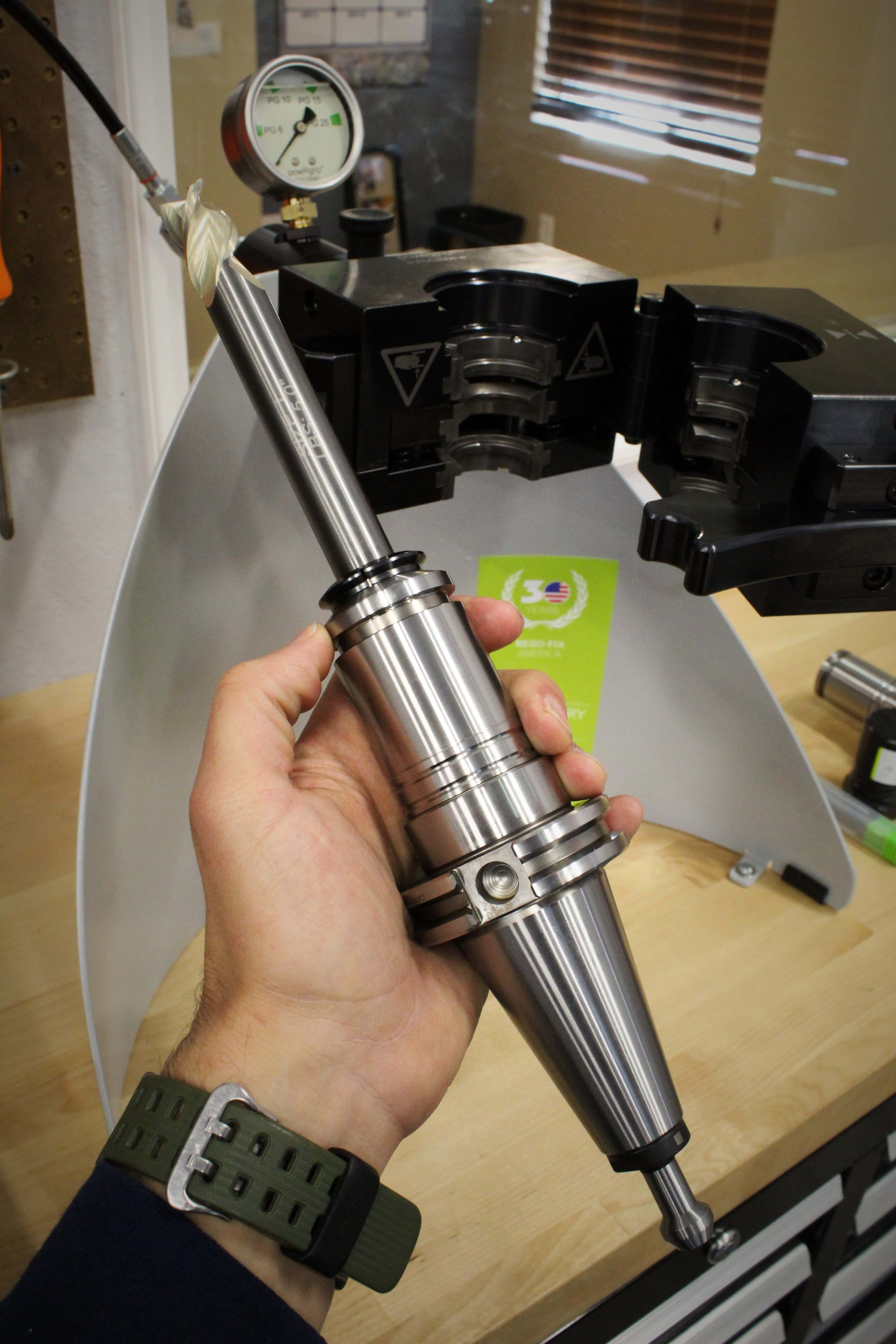

As for tool holding, I ran into an issue last year where I was starting to see a lot of tool pullout and was scrapping too many parts as a result of aggressive roughing. I had to find a better solution, and I came across the REGO-FIX PowRgrip system. It might seem expensive compared to other simpler tool holder, but I think the upfront investment isn’t too bad considering the other options in that space. Again, I invested in technology, and immediately saw better results. I currently use the PowRgrip for finishing passes where I need good runout and heavy roughing where there is the highest risk of tool pullout.

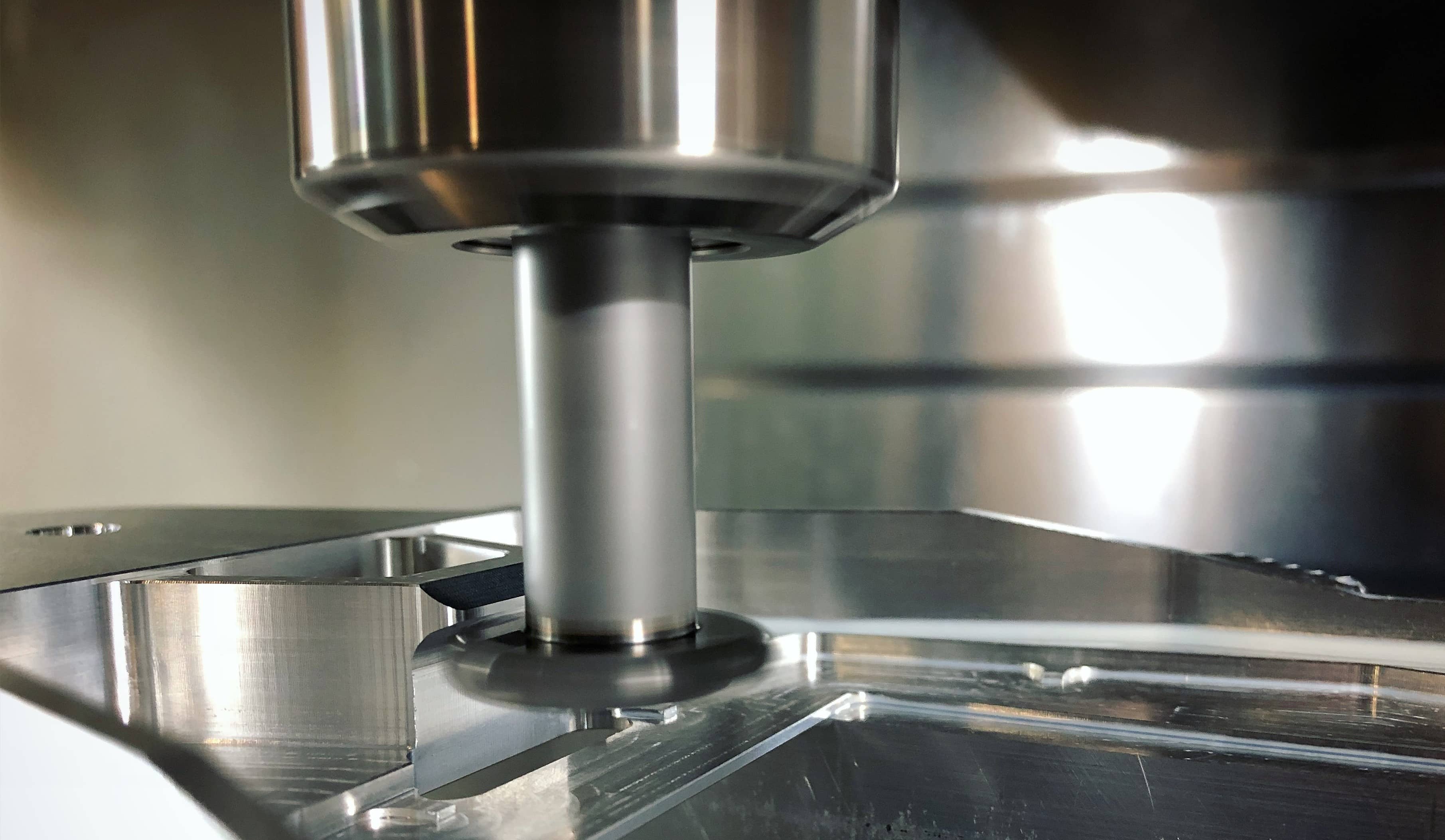

For Harvey Tool, I use a lot of the full radius Keyseat Cutters to surface mill areas you can’t get to with a ball nose end mill. This saves me valuable time because I can avoid flipping the part to surface mill both sides by doing it all in one operation with the Keyseat Cutter.
keyseat cutter
Outside of the keyseats, I use a lot of miniature end mills with reduced shanks and chamfers mills in a variety of angles. I also use lollipops (undercutting end mills) to surface mill parts with hard-to-reach holes.

Shrink Fit Tool Holders
The shrink fit holder is one of the more popular styles of tool holders because of its ability to be more customizable, as evident in the chart above. In this method, a collet is heated to expand, then cooled to contract around the shank of a tool. At room temperature, a cutting tool should not be able to be inserted into a shrink fit holder – only when the holder has undergone thermal expansion due to the introduction of a significant amount of heat should the tool fit. As the holder cools, the tool is held tighter and tighter in place. Typically, a holder is heated through a ring of coils by an induction heater. It is important to heat the holder uniformly, paying mind to not overheat it. Doing so could cause the shank that is being held to expand within the holder and remain stuck.
shrink fit tool holder
Benefits of Shrink Fit Tool Holders
  1. Gripping power. The shank is held flush and uniform against the holder, resulting in a tighter connection.
  2. Low runout. A more secure connection will result in extended tool life, and a higher quality surface finish.
  3. Better balance for high RPM. With a tighter tool-to-holder connection, the opportunity exists for more aggressive running parameters.
