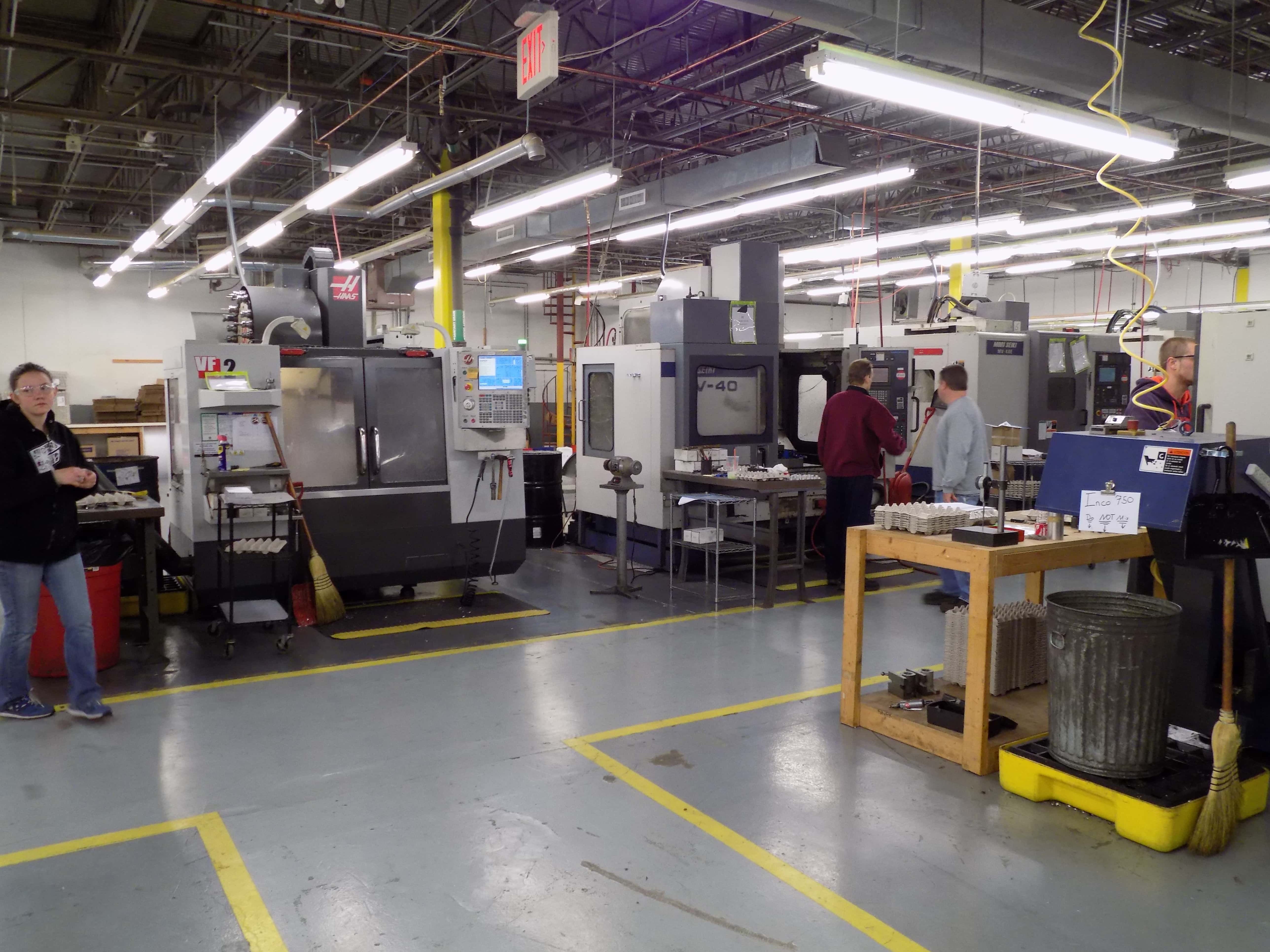

Fleet currently has three two axis turning centers, four three axis VMCs (Vertical Milling), one mill/turn with sub-spindle, and two HMCs (horizontal milling) with sixteen work stations each. It is a long list, but the specific types of machines we have in our facility are listed below. For software, we use a custom Salesforce CRM module, E2 MRP, and Mastercam 2019 for programming.
CNC MILLING
  • (2) Akari-Seiki 450i HMC 27 x 26 x 25 X, Y, Z Travel, dual 400mm pallets, 15,000 RPM, through spindle coolant, 80 tools
  • (2) Mori-Seiki MV-40E VMC 22 x 16 x 18” X, Y, Z Travel, 20 tools, 8000 RPM
  • (1) Mori-Seiki MV-40B VMC 31 x 16 x 20” X, Y, Z Travel, 20 tools, 8000 RPM
  • (1) Haas VF-2 VMC 30 x 16 x 20” X, Y, Z Travel, 25 tools, 10,000 RPM

How has the mill/turn CNC machine helped you speed up production? Would you recommend it to others?
Our mill/turn machine has helped us increase production by reducing our setup time. There is no longer a need to remove a turned part, get it over to a mill, and set everything up again. Most basic milling operations can be performed on the mill/turn machine, so it is a great time saver.
We would definitely recommend this type of machine to other shops. Ultimately, we highly recommend any machine/software/process/ancillary equipment that eliminates or reduces human labor. Manufacturing is a ruthlessly competitive, tech-driven industry and the failure to invest in technology of this type exposes you to over reliance on expensive, scarce, and potentially unreliable human labor and possible obsolescence.
You also have both horizontal milling centers (HMCs) and vertical milling centers (VMCs). What has been your experience with both, and do you prefer one style over the other?
In my opinion, HMCs are superior to VMCs in every respect due to the additional axis, superior chip evacuation, greater load capacity, and the ability to run unattended with pallet pools. VMCs are still useful for simple jobs and rapid prototyping, but for high production runs we lean on the HMCs to get the job done.
