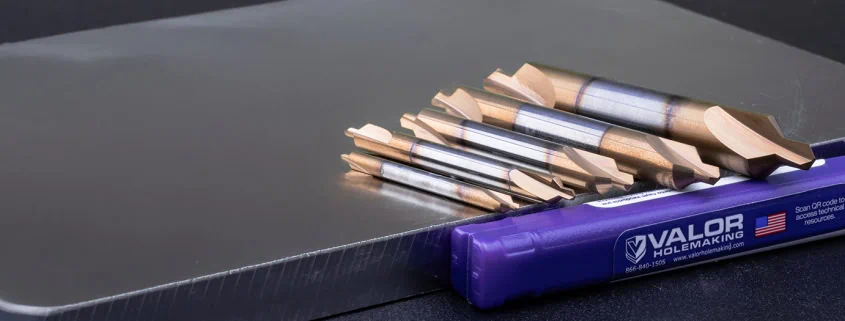

A Combined Drill & Countersink is a specialized tool designed to perform two critical operations in one step: drilling a hole and creating a countersink. These tools are typically short and rigid, ideal for producing either a shallow conic or a center hole. Their double-ended design minimizes downtime by enabling quick transitions between tasks.
Valor Holemaking’s Combined Drill & Countersink
Key Features of Combined Drill & Countersinks
They feature a smaller drilling pilot and larger diameter countersink. The drill pilot resembles a spot drill, making it useful for predrilling applications. The stub length of the drill mitigates deflection and ensures accurate location of a hole’s center. When preparing a spot hole for a longer drill, it prevents walking or wobbling off-center.

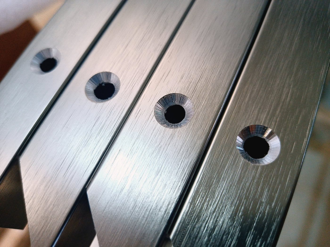

Combined drill and countersinks are also essential in any application where screws need to sit flush in the workpiece. Holes need to be drilled and countersunk across all industries. Flush-mounted fasteners are required in applications such as aircraft panels and structural components, automotive engine components, boat hulls and marine components, electronic device housings, and covers of all types.
Example of countersunk hole
