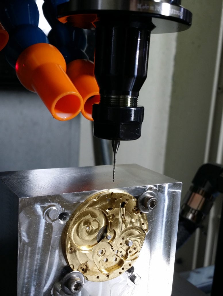

There are a few challenging parts of the watch-making process, starting with the super-tight tolerances. Surface finish is also extremely important, and can be difficult to nail. Many surface finishes in watchmaking are visual, so roughness can be deceiving. We also were forced to design all of our workholding from scratch, as nothing currently existed in the market that would work for our machining process.

I really enjoy fixture design. Holding small parts for fixture design is an art! If it’s too tight, they’re smashed. If it’s too loose, see you later; your part is gone!
