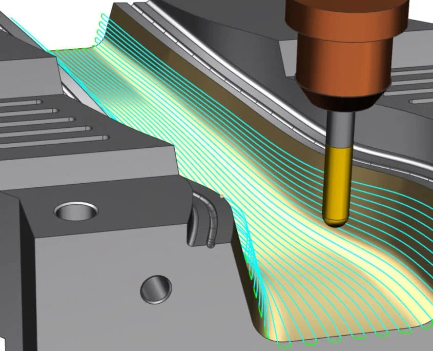

Siemens NX CAM is a powerful manufacturing platform within the broader NX CAD CAM environment, designed to generate precise toolpaths and programs for CNC machines, robotics, and advanced manufacturing systems. It supports everything from model setup through post processing and documentation, with robust capabilities for milling, turning, and automated operations. Its tight integration with NX CAD enables smooth design to manufacturing workflows, while intelligent automation tools such as feature based machining help significantly reduce programming time.
