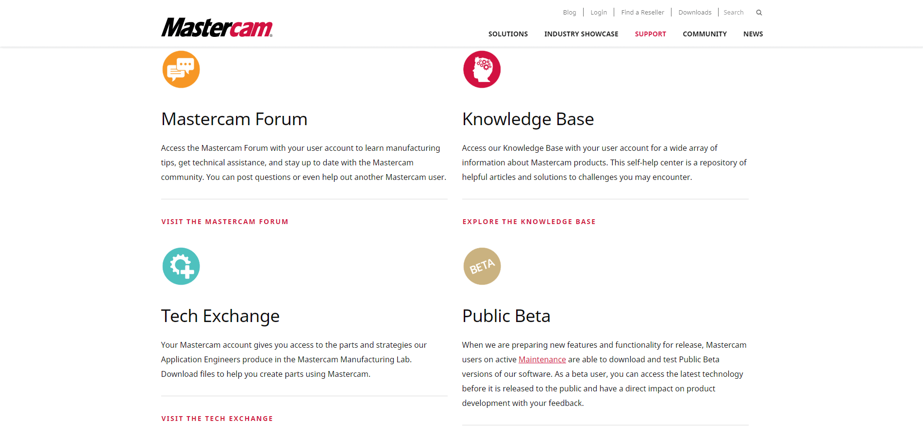

You can find a direct link to Harvey Tool and Helical tool libraries in the Mastercam Tech Exchange by clicking the “Download” buttons in the webpage above, or by clicking the links below.
Another way to download our tool libraries is to head to the Mastercam Tech Exchange by visiting https://community.mastercam.com/techexchange. You will need to be logged in to your Mastercam.com account in order to access the Tech Exchange portal.
Once you are logged in, a database of different tool library files will appear. You can use the search functionality at the top of the page to filter the results by brand name. For example, entering “Helical Solutions” into the search bar will show you only Helical Solutions tool libraries. You can also narrow your search to find Harvey Tool and Helical tool libraries by using the “tags” feature and choosing the brand you are looking for from the drop down menu.

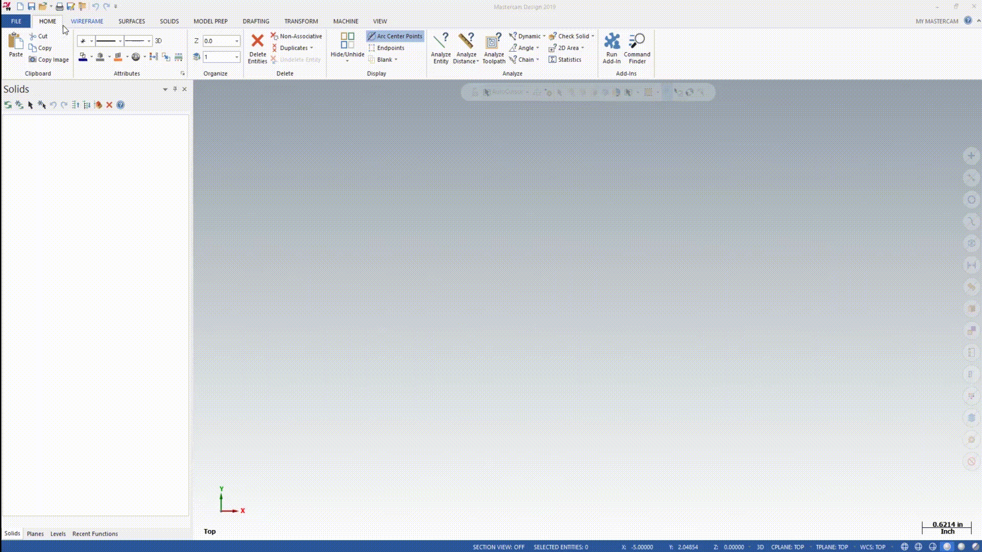

Once you have downloaded your tool library, you will need to import the tool libraries into Mastercam software by heading to the “Machine” tab, selecting “Mill”, and navigating to the “Toolpath” tab to access the Mastercam Tool Manager.
Once you are in the Mastercam Tool Manager, simply click on the folder icon to open your computer’s saved files. Navigate to the folder on your computer where you saved your tool libraries, and select the tool library files you have downloaded to add them to your Mastercam Tool Manager library.
