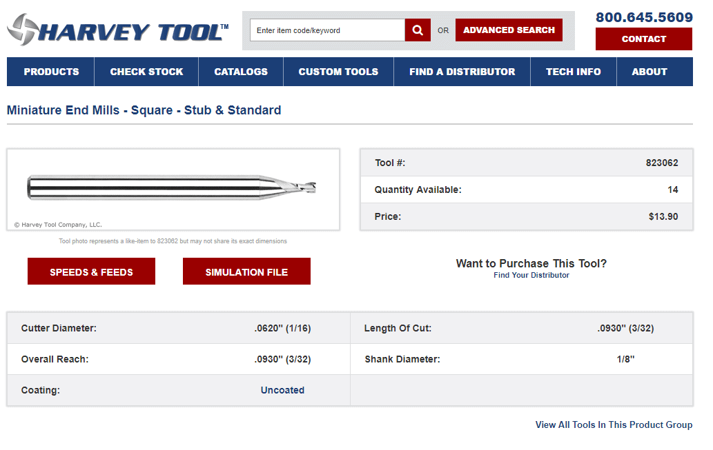

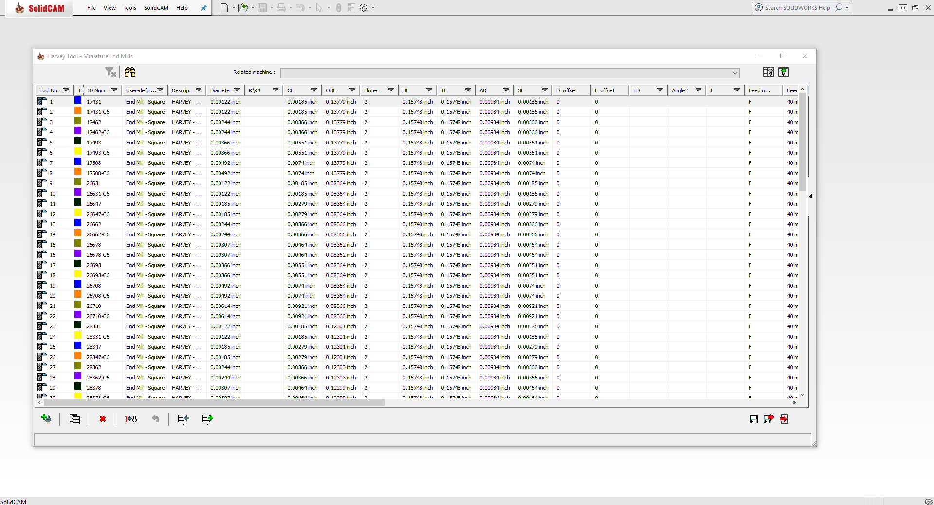

One way to find a tool is to search for a tool by tool number, or EDP number. For example, if you are looking for Helical Tool EDP 00015, you can find the EDP in the “Tool Number” field within the library. You can also click on the binocular icon on the top menu to search by tool number.
SolidCAM Tool Library
You will also be able to sort the library by using the filters on each column. Simply click on the column header to change the filters, or to search within that column. For example, if you wanted to find a .125″ diameter end mill, you could click on the Diameter column and sort from .125″ to .125″ to show only tools with that diameter.
We are also giving users the ability to upload smaller library files from within the larger ZIP file to focus solely on a single product family, which will make for quicker searches. For example, users can import just the Miniature End Mills – Ball library, which will only show you tools from that product family.

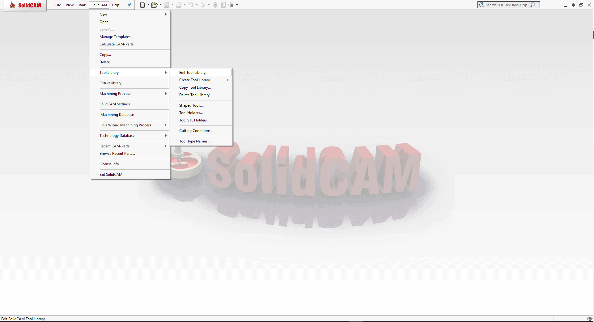

Once you have downloaded your tool library, you will need to import the tool libraries into SolidCAM by clicking on the “SolidCAM” menu on your top toolbar. From there, navigate to the “Tool Library” option in the drop down menu, and select “Edit Tool Library”.
