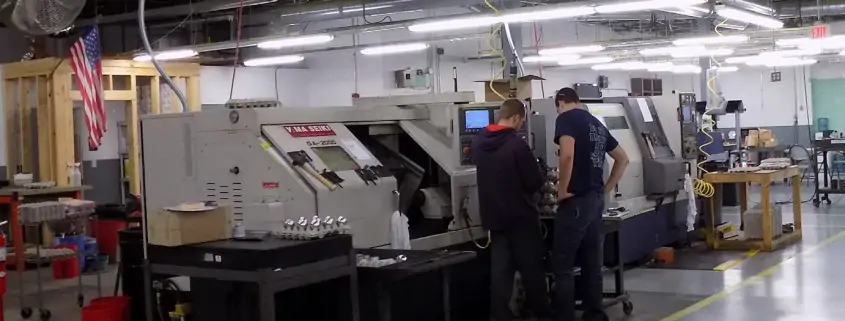

We saw a good mix of machine types while walking around the shop floor. What sort of machines and software do you have here in the shop?
Fleet currently has three two axis turning centers, four three axis VMCs (Vertical Milling), one mill/turn with sub-spindle, and two HMCs (horizontal milling) with sixteen work stations each. It is a long list, but the specific types of machines we have in our facility are listed below. For software, we use a custom Salesforce CRM module, E2 MRP, and Mastercam 2019 for programming.
CNC MILLING
  • (2) Akari-Seiki 450i HMC 27 x 26 x 25 X, Y, Z Travel, dual 400mm pallets, 15,000 RPM, through spindle coolant, 80 tools
  • (2) Mori-Seiki MV-40E VMC 22 x 16 x 18” X, Y, Z Travel, 20 tools, 8000 RPM
  • (1) Mori-Seiki MV-40B VMC 31 x 16 x 20” X, Y, Z Travel, 20 tools, 8000 RPM
  • (1) Haas VF-2 VMC 30 x 16 x 20” X, Y, Z Travel, 25 tools, 10,000 RPM
CNC TURNING
  • (1) Mori-Seiki SL-15 5000 RPM, 9” maximum turning diameter x 16” maximum length
  • (1) Yama-Seiki GA-2000 6000 RPM, 13” maximum turning diameter x 20” maximum length, programmable tailstock, tool setter
  • (1) Doosan Puma 240MSB 6000 RPM, 11” maximum turning diameter, 18” maximum length, dual spindle, live tooling, C-axis milling, tool setter, part catcher/part conveyor
  • (1) Mori-Seiki CL-200 4000 RPM, 11” Maximum turning diameter, 12” maximum length
