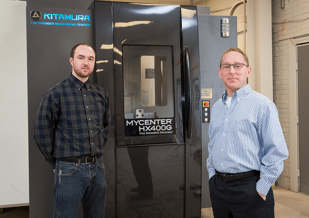

What sort of machines do you use in your shop?
We use an array of modern equipment. 4 axis Kitamura HX400G Horizontal Mills. Nakamura Tome 9 axis Turn Mill, Star 6 axis, and two 5 axis vertical Hurco Machines. All our machines are optioned out with Renishaw probing and all the bells and whistles required to handle high accuracy runs for 24 hours a day with no process issues. Most of the machines have glass scales and thermal packages.

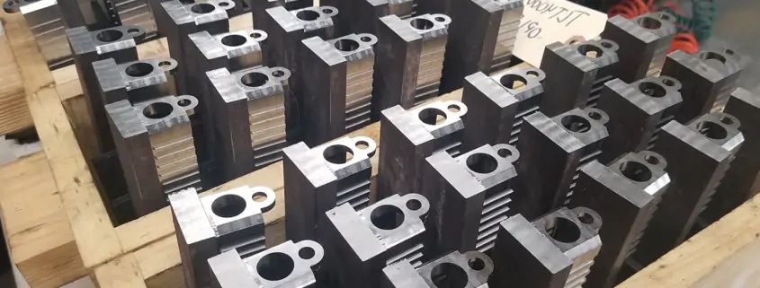

On your website, you mention that TL Technologies has never delivered a rejected part. What sets your quality apart from the competition?
From day one and job one, we worked with the customer to understand exactly how they were measuring the parts, exactly with what tools, processes, and methods to identically duplicate the process in our shop. After replicating key processes we performed many correlation studies to ensure that our measurements were within single-digit microns of what our customers were seeing on their end during inspection. This methodology was scaled up into our overall quality program and allows us to greater understand and manufacture our goods. Our ISO process coupled with this method truly does prevent bad work from getting out. We have never had a case where a part did not function or perform due to our oversight or bad specs. There have been failures on the customer side of things due to engineering, bad prints, and tolerance stackups, but we have not supplied parts that were flat out incorrect.
