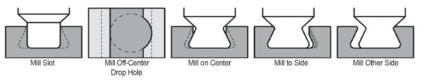

Machining Operation with Drop-Hole Allowance
5 unique machining operations with drop hole allowance
A maximum of 4 radial passes per side are needed.

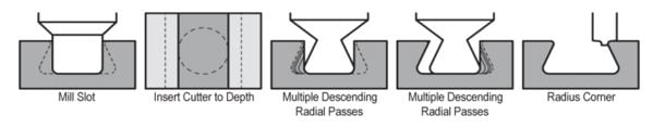

Machining Operation Without Drop-Hole Allowance
machining operations without drop hole allowance
A maximum of 20 radial passes per side are needed.
