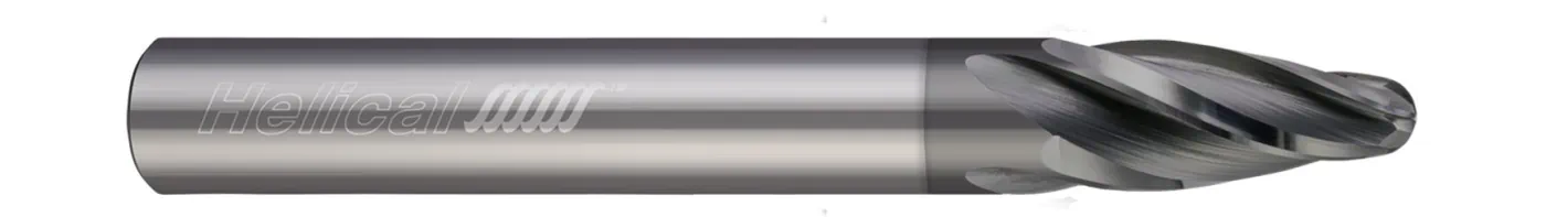

Helical Solutions offers a variety of Tapered End Mills designed to enhance performance and efficiency in tapered wall applications. In this blog post, we’ll dive into the geometry of tapered end mills and explore their common applications to understand when they could be utilized to optimize your CNC machining application.
Tapered End Mill Geometry
Tapered End Mills bring many advantages to machining compared to standard end mills, but what is a Tapered End Mill? A standard end mill will have the same cutting diameter throughout the whole length of cut, whereas a taper mills starts at the shank or neck at a larger diameter and tapers down at a specific angle.
The angle of the taper can vary, but Helical Solutions’ tools feature angles ranging from .05° to 5°, which allows for a broad spectrum of cutting operations. A tapered length of cut or tapered neck can also provide increased strength and rigidity, compared to that of a standard end mill. Having a tapered length of cut makes it easier to create flat tapered walls on 3-axis machines and leads to a better finish.
Tapered End Mill
Standard End Mill
Common Taper Mill Applications
