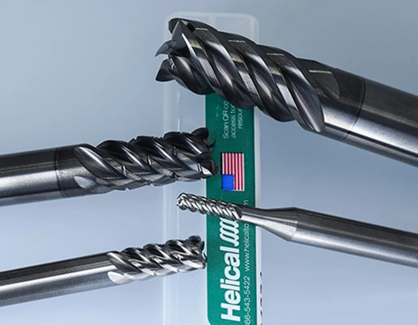

Maximizing Tool Life with Helical’s Dplus Coating
January 29, 2024/0 Comments/in Helical Solutions, Tool Information Guides, Tool Selection/by Harvey Performance Company
Choosing the correct tool coating is extremely important when machining highly abrasive materials like composites, graphite, aluminum alloys, and other non-ferrous materials. Proper coating selection will result in maximized tool life and a higher quality final part. When searching for a coating, it is imperative to find one that has high hardness and maintains a sharp cutting edge, like Helical Solutions’ Dplus coating. This post will explore what Dplus coating is (and isn’t), and when it might help you gain a competitive edge at the spindle.

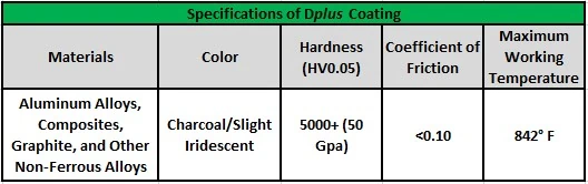

What is Helical Solutions’ Dplus Coating?
Helical’s Dplus is a premium coating, specially engineered to extend tool life when machining materials ranging from aerospace aluminums to graphite or abrasive composites. It has a Tetrahedral Amorphous Carbon (taC) bond structure, which delivers remarkable enhancements in tool life compared to traditional DLC coatings.
Helical’s Dplus coating is applied by a Physical Vapor Deposition (PVD) process. This method of coating takes place in a near-vacuum and distributes micron-thick layers evenly onto a properly prepared tool. Since this coating is applied via a PVD process, it is inherently different than true diamond created through Chemical Vapor Deposition (CVD) processes. While this means it can be outlasted by CVD diamond, Dplus is a thinner coating allowing it to have a sharper cutting edge.
For more information on the PVD coating process, read PVD Coating vs. CVD: Two Common Coating Application Methods.
When Should a Machinist Use Dplus Coating?
When Machining Highly Abrasive Materials
Dplus is an excellent choice when working in abrasive non-ferrous materials like graphite and high-silicon aluminums. It is an extremely hard coating (50 Gpa), which enables it to remain strong against abrasive materials. It also has a very low coefficient of friction, allowing for optimal lubricity. This reduces the risk of built-up edge and ensures chips can be easily evacuated out of the flute valleys.
In Production Runs
The combination of Dplus being an extremely hard and sharp coating, makes it a true winner when it comes to tool life. Using a coated tool in extended production runs can pay dividends at the spindle, especially when working in highly abrasive non-ferrous materials.
Although Dplus takes the spot as Helical’s highest performing coating for non-ferrous materials, it may not be needed in certain applications. Its high hardness and abrasion resistance may be necessary for long production jobs, but may not be necessary for shorter jobs and one-off parts.
When Should a Machinist NOT Use Dplus Coating?
In High Temperature Applications
Although Dplus coating provides outstanding tool life and sharpness, it can’t be run at extremely high temperatures. This coating should not be run in any ferrous material or high temperature aerospace alloys.
Key Takeaways
Featuring an exceptionally low coefficient of friction and extremely high hardness, Helical’s Dplus coating maintains a sharp cutting edge, while still resisting abrasion, making it an excellent choice in low temperature applications of highly abrasive non-ferrous materials.
For more information on Helical Solutions’ coatings, visit https://www.helicaltool.com/resources/tool-coatings.

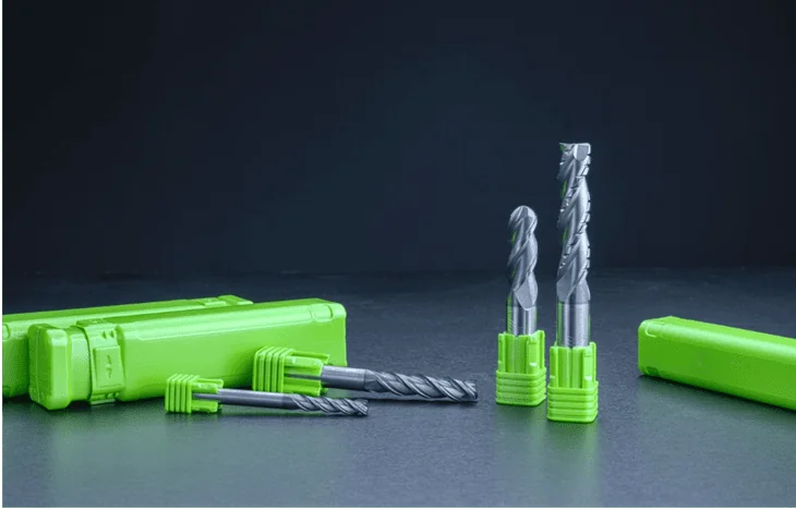

Helical Nplus Coating: Advantages and Performance
April 28, 2022/0 Comments/in Helical Solutions, Tool Information Guides, Tool Selection/by Harvey Performance Company
When it comes to machining difficult materials like high-silicon aluminums, abrasive copper alloys, and other non-ferrous and aluminum alloys, finding a coating that improves performance and increases tool life can be difficult. When machining in aluminum-based materials, machinists often opt for an uncoated tool due to the sharp cutting edge needed. Uncoated tools may give you the sharpest edge possible, but Helical’s Nplus coating helps combat wear and keep your edge sharp for longer, allowing you to win at the spindle and gain a competitive edge.
What is Helical Solutions’ Nplus Coating?
Helical’s Nplus coating is applied by a Physical Vapor Deposition (PVD) process. This method of coating takes place in a near-vacuum and distributes micron-thick layers evenly onto a properly prepared tool.
Nplus is a premium coating, specially engineered to extend tool life when machining non-ferrous and aluminum alloys.
nplus coating chart
The above image was taken from Helical Solutions’ Coating Chart.
When Should a Machinist Use Nplus Coating?
When Machining Non-ferrous and Aluminum Alloys
Helical’s Nplus coating is optimized for machining difficult aluminum alloys and other abrasive non-ferrous materials, as its composition doesn’t react with aluminum as some other coatings do. This coating possesses many advantageous qualities, including its high hardness (40 GPa), which provides excellent edge retention to ensure that your tool stays sharp for longer. Also, its high working temperatures (2,012°) and its thickness (1-4 µm) provide further wear resistance when tackling these difficult-to-machine materials.
Nplus coated Helical end mills
When Working in High Temperature Non-Ferrous Applications
When machining in many non-ferrous and aluminum alloys, high temperatures can become an issue. Nplus is specially designed to withstand temperatures up to 2,012°, allowing tooling to run at the high temperatures these abrasive materials require, without degrading them.
When Machining Large Production Runs
Machining materials like wrought aluminum, cast aluminum, graphite, and other non-ferrous alloys can quickly end the life of your tool, costing time and money. Nplus coating is specially engineered to extend tool life in these materials, allowing your tool to stay in the spindle for longer. This calls for less tool changes, creating a more efficient process flow in your large production runs.
Helical’s Nplus Coated Tooling
Helical’s 5 Flute End Mills for Aluminum
Introduced in Helical’s Spring 2022 Catalog, Helical’s 5 Flute End Mills for Aluminum are specially engineered for optimal performance in High Efficiency Milling (HEM) of aerospace aluminum alloys and other non-ferrous alloys. They’re offered in two unique styles, both fully stocked in Helical’s Nplus coating:
5 Flute – Corner Radius  – Variable Pitch – Chipbreaker Rougher
5 Flute – Corner Radius – Variable Pitch – End Mill
Helical’s Multi-Axis Finishers for Aluminum
Also introduced in Helical’s Spring 2022 catalog, this offering of Multi-Axis Finishers feature a specially defined profile for massive reductions in cycle times and vastly improved surface finish when machining aluminum.  They’re offered in 3 styles, all fully stocked in Helical’s Nplus coating to ensure excellent finish in abrasive aluminums and extended tool life in a wide variety of non-ferrous materials.
Multi-Axis Finishers – 3 Flute – Lens Form
Multi-Axis Finishers – 4 Flute – Taper Form
Multi-Axis Finishers – 4 Flute – Oval Form
