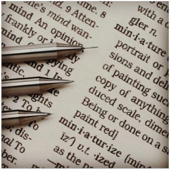

High precision machining is a subset of subtractive manufacturing that has grown in popularity over the years, especially as industries like medical, dental, mold tool and die, and semi-conductor manufacturing grow. Some jobs can call for extremely small diameters (down to even .001”) and ultra-precise tolerancing. With tooling this miniature, machinists must utilize different machining practices than they otherwise would, as common issues that would arise with larger end mills are magnified within miniature tooling applications.  Speeds and feeds become critical to ensure your tool survives the job.

When breakage happens with miniature tooling, it’s important to determine where on the tool the breakage is occurring. Breakage points are sometimes quite difficult to see with such small tooling. Finding the location, when possible, helps to diagnose the issue. For example, if the breakage occurs along the length of cut, there could be chip packing. If chip packing is the issue, it’s helpful to decrease the feed rate and lower the depth of cut per pass. If the tool breaks on the transition angle toward the shank, this could be due to a few things. The first instinct should be to check the runout of the tool. Runout should be measured at less than .0001”. In this case, check tool set up to ensure that the tool is stable within the tool holder. Another issue could be excess pressure on the tool caused by high pressure coolant or even deflection. Deflection occurs when the cutting pressure causes the tool to bend slightly – in this case, the tool will break at its weakest point. To minimize the opportunity for deflection, ensure the tool is the largest diameter and shortest length of cut possible for the job.
