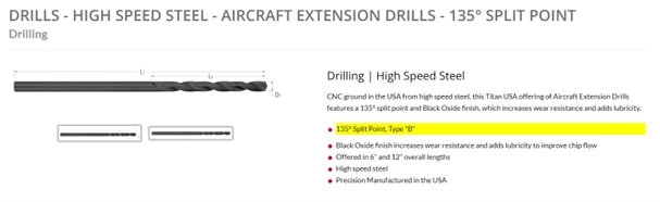

All the drills that call out a type in Titan USA’s catalog are NAS907 standard drills as they all have drill diameters of 1/16” through 1/2” and straight shanks. Below are examples of Titan USA drills of types B, C, and J within that standard:
Type B

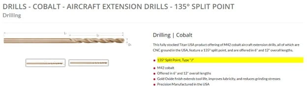

Type J
Screenshot from Titan Cutting Tools of a Type J aerospace drill

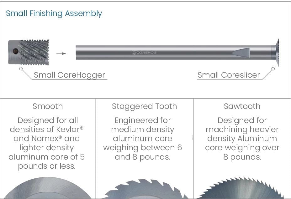

Small Finishing Core Tools
Optimized to machine small, closed features in composites, such as pockets, joggles, and closed walls, Small Size Finishing Tools are engineered for the superior finishing of honeycomb core materials. This configuration includes a Small Coreslicer with three different edge options: Smooth, Sawtooth, or Staggered Tooth, and an optional Small CoreHogger. The right edge style for the Coreslicer depends largely on the material you’re working in. While a Smooth edge style works well in lighter density honeycomb core materials such as Kevlar®, Nomex®, and Aluminum, Sawtooth and Staggered Tooth options work best for honeycomb core materials with densities of 6 pounds or higher, such as aluminum core, Kevlar®, or Nomex®.
Key Benefits: Eliminating the risk of material wrapping around the spindle by disintegrating them as they approach the face of the slicer.
Browse Small Finishing Core Tools

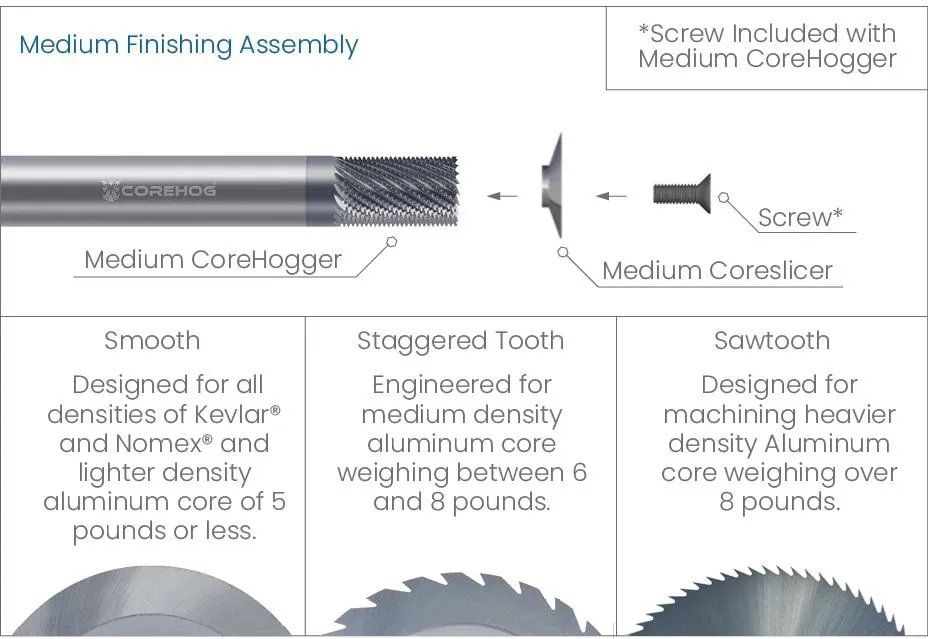

Medium Finishing Core Tools
Designed for finishing honeycomb core materials, this assembly style CNC tooling is engineered for shaping smaller complex surfaces, bevels, and external radii. For this configuration, a Medium CoreHogger and a Medium Coreslicer must be utilized and fastened with a screw. Similar to the Small Finishing Core Tool options, this assembly can be used with a Smooth, Sawtooth, or Staggered Tooth Coreslicer edge.
Key Benefits: This Medium Size Finishing Tool offering includes both carbide and high speed steel options. The carbide version is uncoated, whereas the high speed steel version is TiCN coated for extended tool life and improved wear resistance.
Browse Medium Finishing Core Tools

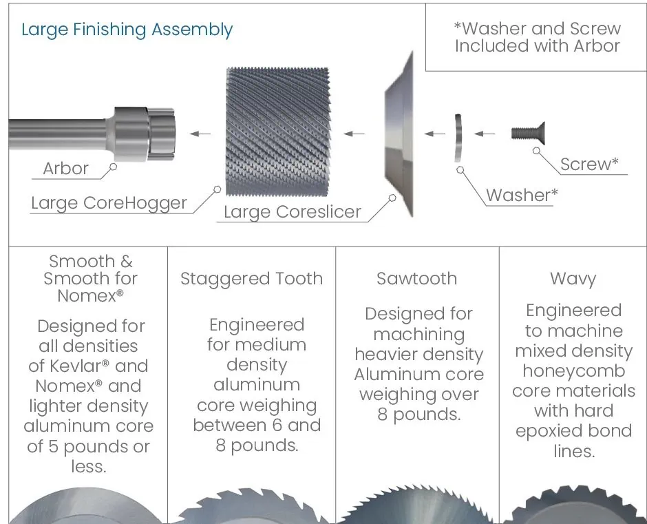

Large Finishing Core Tools
Designed to vastly reduce cycle times while finishing honeycomb core materials, this assembly style tooling removes large volumes of material quickly, while providing excellent surface finish and keeping tool pressure and heat low.
Large Finishing Core Tools require a slightly more complex configuration. This type of modular tool features an Arbor, which includes a washer and screw; Large CoreHogger; and Large Coreslicer. For this assembly, four types of Coreslicer edge options are available: Smooth, Sawtooth, Staggered Tooth, or Wavy. Wavy style options are best utilized in heavier density types of Kevlar®, Nomex®, and Aluminum Core, and are engineered to be useful when machining parts that contain bond lines.
Key Benefits: The Arbors in this configuration are heat treated and finish ground for extremely tight tolerances in runout, concentricity, and perpendicularity. With tighter tolerances, harmonics are minimized while longer tool life and better part finish are observed.
Browse Large Finishing Core Tools

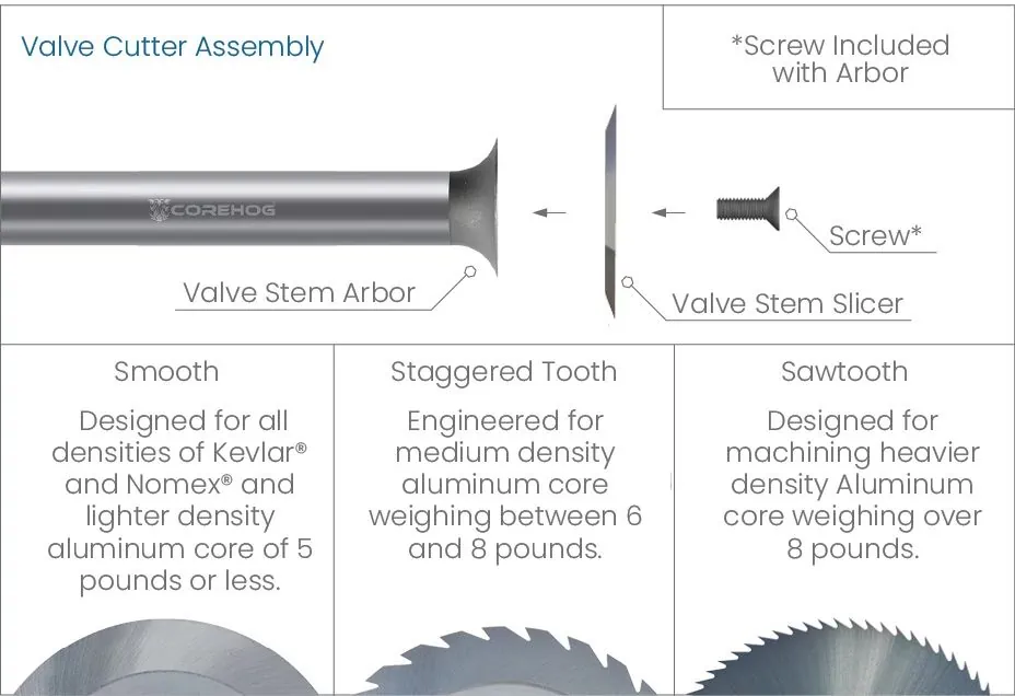

Valve Stem Cutters
Different from CoreHog’s Finishing Core Tools, Valve Stem Cutters are assembly tooling engineered for machining honeycomb core materials and finishing thin features, such as bevels and knife edge parts. To build a Valve Stem Cutter, utilize an Arbor, a Valve Stem Slicer, and a screw to fasten the two together. Similar to Small and Medium Finishing Core Tools, the Valve Stem Slicer can feature a Smooth, Sawtooth, or Staggered Tooth edge profile.
Key Benefits: The Stem design of CoreHog’s Valve Stem Arbors is optimized for free flowing applications, eliminating grabbing when machining Honeycomb Core Materials.
Browse Valve Stem Cutters

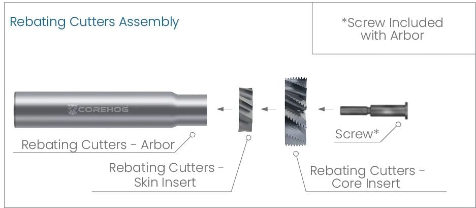

Rebating Cutters
Machinists may opt to use a Modular Rebating Tool if they are aiming to reduce setup, minimize cost per cutter, and obtain flexibility with varying sandwich panel configurations. For this configuration, an Arbor connects to a Core Insert, Skin Insert, and is fastened with a screw. Here, the Arbor, which features a .500” shank diameter and a 3” overall length, can be paired with multiple sizes of Core Inserts. As of September 2022, CoreHog’s offering of Core Inserts range in diameter from .875” to 1”, with a length of cut spanning from .160” to .312”. All Inserts feature TiAlN coating, which provides high hardness and high temperature resistance. Finally, the Skin Insert features a ½” diameter, and provides a machinist with the option of DLC or CVD Coating. While DLC coating provides optimal performance, true crystalline CVD diamond coating works to significantly extend tool life.
Key Benefits: The complex geometry of Sandwich Panel Cutters – Arbors helps to reduce tearing, flagging, and fuzz, while providing a rebated area to allow for edge filling or fasteners, later on.
Browse Rebating Cutters
