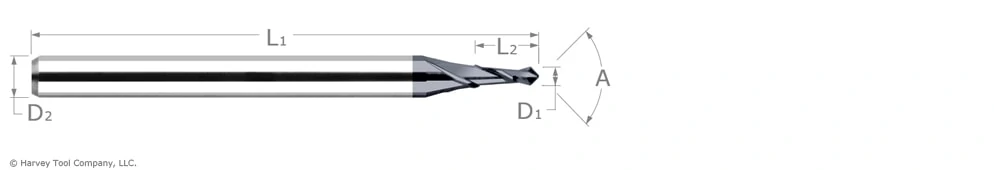

What is a Combination Drill & Countersink Tool?
A Combined Drill & Countersink is a specialized tool designed to perform two critical operations in one step: drilling a hole and creating a countersink. These tools are typically short and rigid, ideal for producing either a shallow conic or a center hole. Their double-ended design minimizes downtime by enabling quick transitions between tasks.
Valor Holemaking’s Combined Drill & Countersink
Key Features of Combined Drill & Countersinks
They feature a smaller drilling pilot and larger diameter countersink. The drill pilot resembles a spot drill, making it useful for predrilling applications. The stub length of the drill mitigates deflection and ensures accurate location of a hole’s center. When preparing a spot hole for a longer drill, it prevents walking or wobbling off-center.
Common Applications for Combined Drill & Countersinks
Many holemaking applications begin with spotting and end with countersinking, making combination multi-functional tools cost-effective and time efficient. As the tool drills into the material, the larger countersink diameter chamfers the top edges, allowing fasteners to sit flush with the surface.
Where and How to Use a Combined Drill & Countersink
The primary use of a combined drill and countersink is to create center holes in materials that will be turned between two centers. These centers help accurately position a workpiece along its axis between a lathe chuck and tailstock. Live centers are used in applications requiring a high level of concentricity and support. They typically feature a 60° included angle, which is the angle most combined drills and countersinks are manufactured with. For this reason, combined drill and countersinks are often referred to as center drills.
Combined drill and countersinks are also essential in any application where screws need to sit flush in the workpiece. Holes need to be drilled and countersunk across all industries. Flush-mounted fasteners are required in applications such as aircraft panels and structural components, automotive engine components, boat hulls and marine components, electronic device housings, and covers of all types.
Example of countersunk hole
Types of Combination Drill/sinks: 60°, 82°, and 90° Angles
Harvey Tool and Valor Holemaking offer combined drill and countersinks in 60°, 82°, and 90° included angles. While 60° tools are most commonly used for center drilling, 82° and 90° included angles are designed to match the angles of the most popular flat and oval head screws. These tools allow users to create countersunk fastener holes in a single step.
Important Tips for Running Combination Drills
When running a combined drill-and-countersink, it is important to ensure that chiploads (IPR) are based on the drill diameter. Since the drill diameter is always smaller than the chamfer area, it is safer to use parameters designed for the drill portion of the tool rather than calculating an effective cutter diameter for the chamfer.
Valor Holemaking Combined Drill & Countersink in the Spindle
