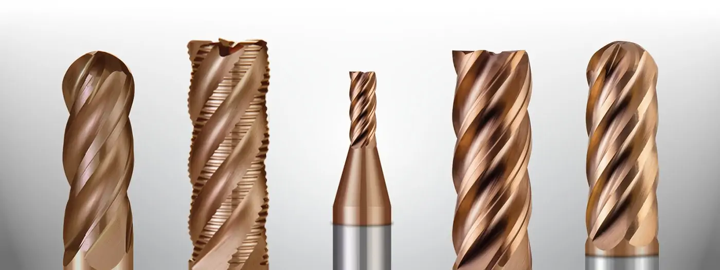

tplus coating on helical end mill

Helical’s Tplus coating is a Titanium-based, multi-layered coating that is applied by a Physical Vapor Deposition (PVD) process. This method of coating takes place in a near-vacuum and distributes micron-thick layers evenly onto a properly prepared tool.  Tplus is a premium, multi-layered, titanium coating that increases edge strength, wear resistance, and tool life.

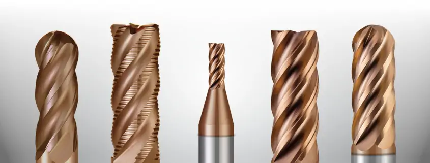

Helical Solutions’ 7 Flute Tplus End Mill
