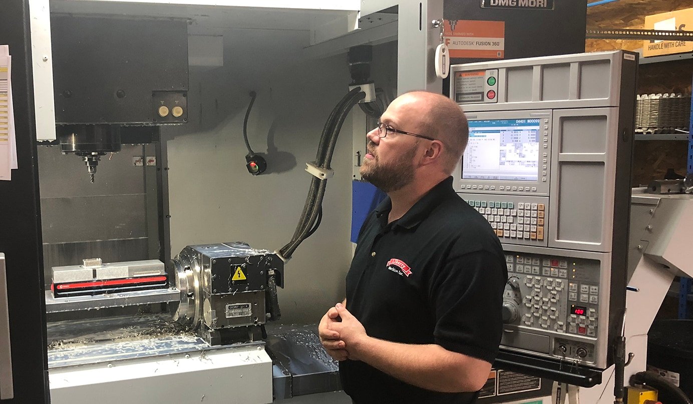

You have a great shop here and are definitely maximizing the space. How much square footage are you working with?

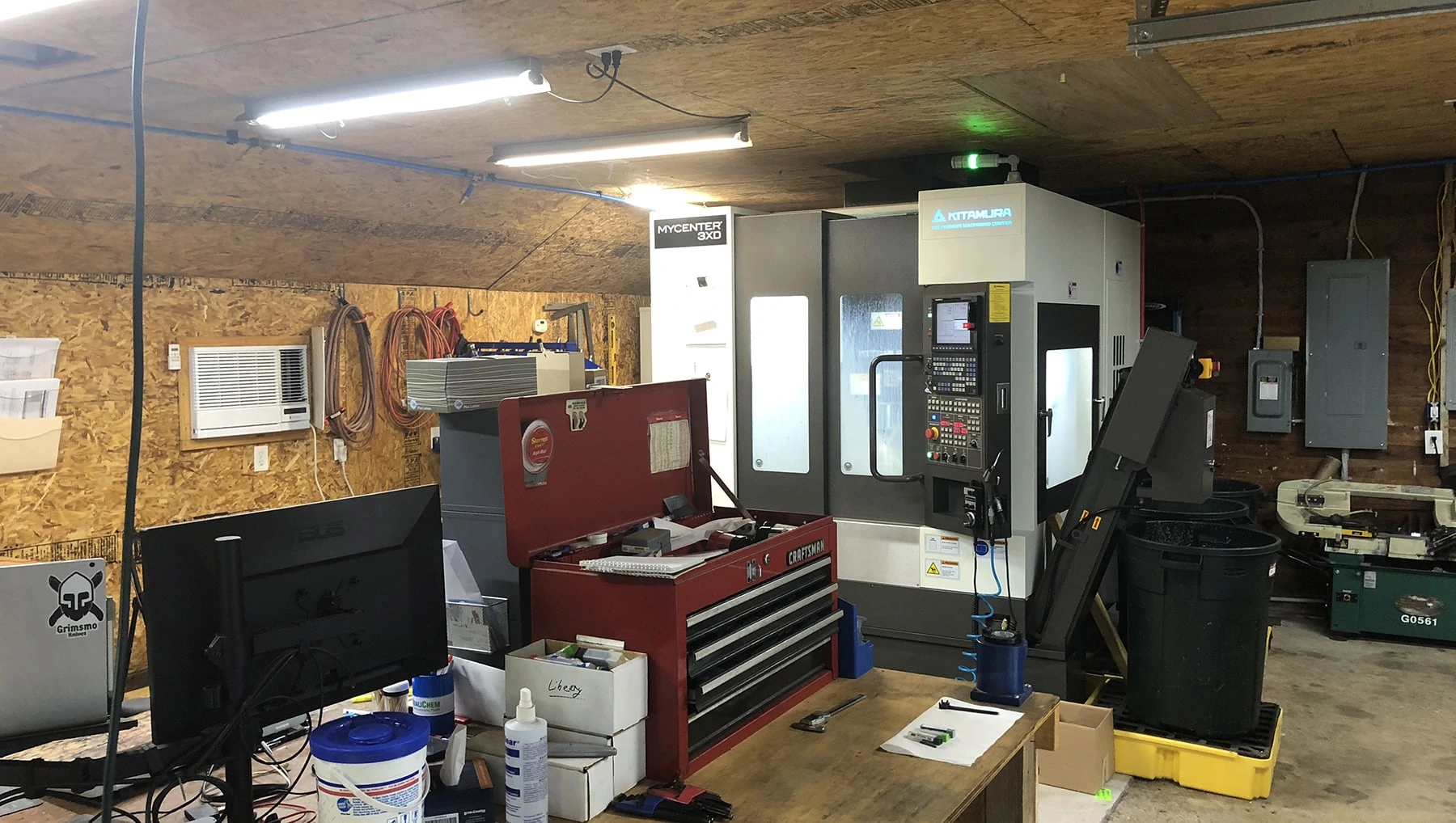

Currently, we are working out of a 940 sq/ft shop. We “technically” have room for one more CNC mill if we really squeezed things together. I don’t think that is in the cards though; it is more likely that we will move to a larger space if and when the time comes for expansion. Heat management and air quality are real issues when working in small spaces with low ceilings, which is something we deal with currently.
What sort of machines and software do you have here in the shop?
For now, we have two VMC’s and a decent amount of inspection equipment. We have the DMG Mori machine I previously mentioned, as well as a 2016 Kitamura-3XD. Both machines have 12k spindles, Renishaw probes, and feature coolant through spindles.

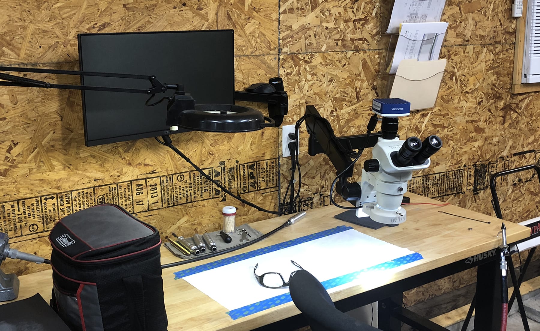

For inspection equipment, we have a 2014 Mitutoyo QM-Height 350 Digital Height Gage, a 2003 Brown & Sharpe Gage 2000 CMM with Renishaw MIP Articulating Probe Head, and a 2003 Mitutoyo PH-A14 Optical Comparator. We also recently acquired a Scienscope Stereo/Digital microscope. This allows us to perform visual inspection of our parts at an extreme amount of detail.
Liberty Machine
Photo Courtesy of: Liberty Machine, Inc.
There are still holes in our inspection lineup, so we are always looking at adding onto what we do to provide our customers with quality machined products.

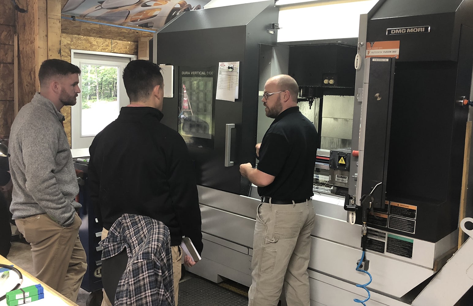

Is it true that you built an addition to your garage specifically for the DMG Mori machine?
That is true! Before I bought the machine, I knew it was going to be too tall for my existing space, and was also going to need a solid foundation to sit on (it weighs 7 tons). Before the machine arrived, I had a concrete slab poured right against the side wall of the existing garage, and placed the DMG Mori on that slab.
After a couple days of unfortunate rain and multiple layers of tarps covering the machine, I had several family members (carpenters by trade) help me build the addition. Ok…I helped them. They were able to get it all framed and covered in just one day, breaking down the side wall of the garage and literally building the new space around the dimensions of the machine. Like they say, if there is a will, there is a way!

In the video below, we first toured our Gorham, Maine manufacturing plan with Plant Manager Adam Martin. Then, we ran a few tests with the Helical tools on our Haas machine, before heading back to our warehouse in Massachusetts to talk about fulfillment and new products with Fulfillment Manager Megan Townsley.

We Take Quality Control Seriously
Our high performance end mills go through an extensive inspection and quality assurance process before they end up in your machine, with multiple inspection points along the manufacturing journey. At the 17 minute mark of the video, you can learn more about how we monitor the quality of the tools in batches as they are manufactured. If you skip ahead to the 29 minute mark, you can see some of our more advanced inspection machines in action.
